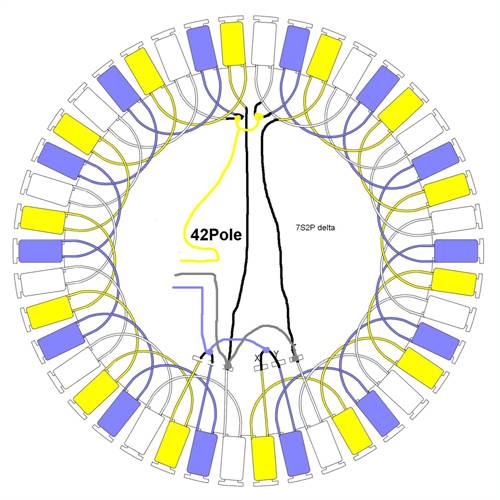

Can anyone in the know check that I have this wiring correct please?
7 poles in series and 2 parallel – delta (7S2P delta)

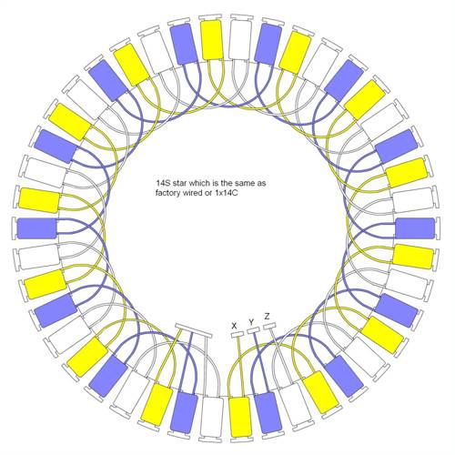

and the other stator is ment to be 14S Star.

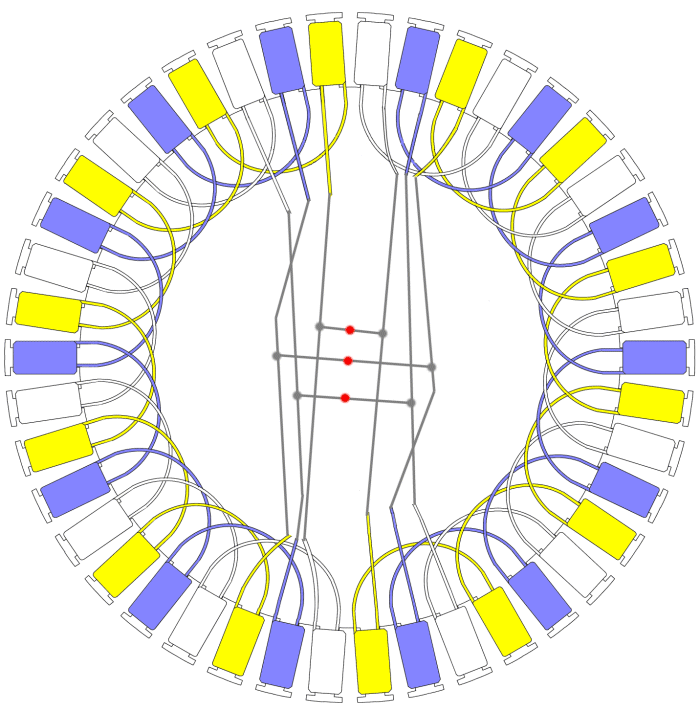

I think the reason you didn't get any replies is the drawing you put up is wrong and drawing these diagrames takes a lot of work and time. Besides, some posts here will get many hundreds of views per post.
I've done a simple diagram, the red dots are the output onnections.
Let me know if it doesn't make sense.

Thanks Gizmo, yes that makes perfect sense.
It looks like I had the right idea electrically but the delta wiring the way I had done it would not have been in phase. eg I joined them at the wrong end. Or not electrically balanced for want of a better description.

PS Edit the second picture in your original post is as standard from the washing machine, and yes is 14S starEdited by Trev 2010-09-18
