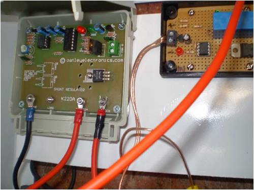

My charge controller seems to be controlling my rpm, as soon as it reaches around 27 volts the mill will not go any faster, If I disconect the positive to the charge controller the speed increases and the voltage increases.
I posted a topic a few weeks ago on low amps, at the time there was no wind and I turned it by hand,I was getting 24v but only 1amp. It seems to be the same with the wind, the stator is a 2X7C. My other stator 7X2C allows the mill to go faster, but still limits the rpm when 27v is reached.
Is this normal?

Yeah thats perfectly normal. Your windmill is limited to 27volts by the battery bank and controller, and that 27 volts matches the rpm it seams to stop at. Its a limit of the turbine, it hasnt got enough power to push the RPM up above the 27 volt limit.
If you have light winds, the 2X7C is the way to go, and for high winds the 7X2C. The 7X2C could make more power, but only if you have enough wind to drive it fast enough.
If your only getting 1 or 2 amps, I would suggest you use the 2X7C and some bigger blades.

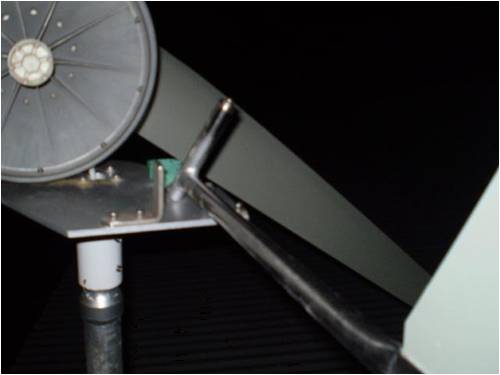

Looking at your photo there seems to be no furling and just a tail stuck out the back.
This is wrong and needs the tail offset.
There is many adjustments you can make to the tail but you need to get the basics sorted first.
Can you give a photo of the tail setup.
Pete.

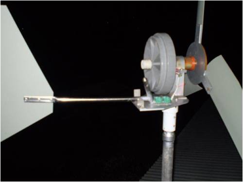

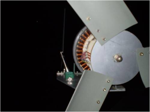

Ok, I have just gone up there in the dark and taken these, they are blurred because I couldn't see anything I just pointed in the right direction.
Looking from the top, down, the centre distance between the shaft and tail is 150mm
and the pivot point for the tail is 20 degrees in two directions.
jasmine
Posted: 01:25pm 18 Sep 2010
It is hard to tell, but do the pivot for the tail slopes backwards only or back and to one side as the first photo shows it leaning to the right.
The tail pivot should slope backwards only at around 15 degrees towards the tail, not left or right as well.
The photos are clear but the angle is hard to tell.
Pete.

Hi Pete, it slopes backwards 20 degrees and looking from the front slopes 20 degrees
to the left, I'm pretty sure I got this information off this site, the bachward slope is fixed however the side slope is adjustable to upright. Thanks for any info.

Yes i think you are right with your tail pivot.
Back to the tail.
A larger or longer tail will have a greater dampering effect, so can adding weight to the tail.
Adding weight will depend where you put it, the further out the tail the less weight required.
I see tail length/size as a coarse adjustment and weight as a finer adjustment.
Pete.
