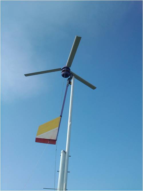

Much to my surprise, it was trying to fly UP!
Took a leaf out of Jimbo's book, just because we could!
Nature of the failure VERY lucky!! prop going this way instead of via the tower
Datalogger shows 41.6m/s or just under 150KM/hr winds at some short time before the failure occurred but in the words of Gordon the great
"ANY WINDMILL LEFT UNATTENDED WILL FAIL"
this is the first maintenance it has needed, bearings still A1, stators show no signs of corrosion, tail needs a repaint, blades are perfect, still in balance too.
I also note not many 'mills have survival speeds greater than 40m/s and much to Phill's credit he has offered not only to fix it, but fix it better!
What a beast!, destined to fly again soon. BTW 315KW/hrs on the dial so far in 7 ish months.

I think that is the luckiest failure i have ever seen.
You could not design it to fail like that if you tried.
It really comes back to the many conversations that we all have of underestimating the force of the wind for those 1 or 2 days a year.
Mother nature will always win. (she's a bitch like that)

As we have already discussed the fix which will be to extend the yaw bearing shaft through the box section which will srengthen the failure area to the point where it should be good for 80m/s, hopfully that doesn't get tested.
I think increasing the off-set adj to allow earler furling will also be a good move.
From the pictures it is unbelievable that no other damage was done , I must say though, that the hammering this mill takes in your wind zone and being grossly over powered in the blade dept with the 3.050mt Al blades on a f&p dual, I could only imagine the blades are getting up over 850RPM and the forces it has to deal with in wind of 40M/S ( 130+ KLM ).
It would be great if we could see what is happening with this mill with a live piclog set up.
In the past weeks down there the wind strength has been cyclonic and must have taken its toll on quite a few mills , I know that the figures that Amack was punching out at approx the same time out of one of the Chinese 500W Conversions that I sell also eneded up in smoke after punching out over 1600W , I will be posting a full story on that soon as the mods that are to be trialed should be ready to be flown again soon .
I suppose it comes down to the question , Do you lock down your mills when a extreemly high wind event is approaching and live to fly the next day or keep on engineering to survive the 1 to 2 Days a year or the 1 day in 5years and so on .
Its great to see the big figures, but in the long run everything has its limits, and for a few hours punching out record figures being wasted in dump loads that can mean weeks of constant power loss to be able to find out the weak points that can sometimes be benificial to others only if they are able to build to the specifications of that particular mill.

Looking at the photo you posted I must agree with Phills comments on the oversize blade being a contributing factor, as the gyroscopic forces of that size blade acting through the critical point where it failed are enormous, the furling of the blades creates these stresses, and making it stronger there will transfer the stresses to the next weaker point of construction.
What it needs is a yaw damper to slow the furling so it isn't wip furling on gusts as that is what is causing the damage.
Karl, you will be aware of the damper used on helicopter blades for this purpose, without it the rotor head will destroy its self in short time.

When you have that box fixed you may want to have it stress relieved, or normalized.
It looks like the crack followed the weld around for a ways then probably the weight took over and started to peal the metal out.

I dont think a damper on the furling would make a difference, the furling is SMOOTH as silk but yes she's really hooting when it furls off, to the point where even furled the power being produced barely drops off.
The real solution is to start sneaking away coin from the missus and go the AXFX, thats still the goal, will be able to extract 4-5times as much power hence keeping the numbers in better control.
Phillm and I will talk how many golden coins sooner or later and i'll give it to the old man for his '70th birthday....
I guess more important again to get the furling spot on to avoid the burnt stator that happens with all Axial flux mills when they are pushed beyond limits -unlike the f&P which survives anything. -even abuse!
Karl,
Examine the point where the crack starts with a magnifying glass (if necessary). You may be able to see different grain sizes (increasing in coarseness) radiating out - and possibly slightly different (shades of) colours in some sort of 'concentric circle' pattern.
From the shape of the tear, it is doubtlessly due to re-crystallisation in the weld boundary.

Its an atypical weld failure, ie weld didnt fail, the surrounding material did.
Obviously to tear 5mm thick box section required some very serious loads.
All part of the fun and to say I'm happy that Phillm is taking care of it s an understatement, the fact he stands behind the mills is very comforting.
My initial thoughts were to beef it up and weld it back together, but Phillm came up with a far better idea that will strengthen it up no end.

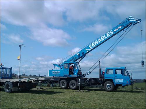

The crane we got as we couldnt actually see what had failed or what was holding on to the mill head.
Hence it was simply a preservation exercise,my mill needs no winch, it is balanced and pivots over for maintenance.
My fear was that if i pivoted it over and the mill broke off and hit the ground OR ME...
we would have been up sh!t creek. This was the safest method to get it down without breaking me or the mill.
Had I known the failure was as we see it here -no problem.
If something different was the case, ie just being held by the wiring which had chaffed away over the previous couple of days might have been a very different picture.
It wasnt that long ago the forum mourned the death of a father and son whose windmill touched powerlines while they were moving it across the farm, having a wife in OHS and taking safety as seriously as I do this was the best choice to make.
