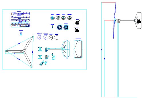

In Annex I attach my whole project with Autocad
At this link: http://energiaalternativa.forumcommunity.net/?t=30116645 you will find a precent my realization.
Forgive my bad English, I write from Italy with the help do google translator.
Un Saluto un "tutti":)

Do you have the Autcad files as a ZIP?

Forgive me here is the file
2010-10-09_191521_Progetto_turbina_2Kwp.rar
IPSA SCIENTIA POTESTAS EST (bacone)
Posted: 11:07am 09 Oct 2010
Almost, here I've done it for you.
2010-10-09_210630_Progetto_turbina_2Kwp.zip
Its a DWG file, very good.
Thanks for posting.

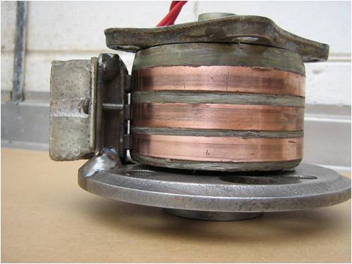

I can only agree with all that has been said, a Job well done. I have built a 500W windmill of similar design but this has inspired me to go for a bigger unit and looking at those nice pictures gives me that extra push (I hope) I have always wanted to include slip rings and you make it look so easy. I was thinking of using car alternator brushes and copper pipe cut into rings cast with resin, but your idea seems repeatable. I will look at the Autocad files tomorrow.
Now just imagine....MPPT with this turbine.....
Thanks a lot.
Leon
ZS5QY
Happy Solarwinds
Posted: 02:38am 13 Oct 2010
Funny you should say about using copper pipe rings set in resin and car alternator brushes.
I just finished a set of slip rings using all these things.
Pete.
Altenergy
Joined: 19/09/2010
Location: South Africa
Posts: 7
Posted: 05:47am 13 Oct 2010
Pete
Could you post more pictures of this brush set-up. How the brushes mount etc. Show the other side, top, bottom, we want it all!
Great work
Leon
ZS5QY
Happy Solarwinds
Posted: 07:08am 13 Oct 2010
So as not to hijack this great thread any further i will start a new one called Slip rings with some more photos.
Pete.
