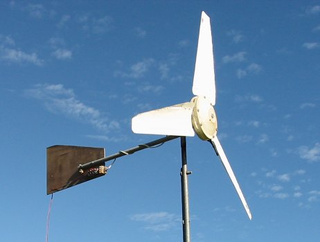

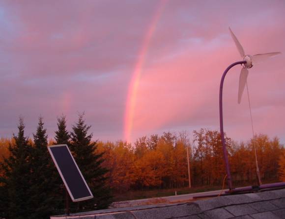

I snaped this picture of the gold found in DIY windmills. This conversion produces 200 watts and uses 12 ceramic magnets. I have two set of blades for it. The ones on it now are slower but they start easy. 600rpm at 50km
The tower is a recycled hanging wicker basket chair.
Very cheap to build.

Hi WXYZ
Very nice but bloody big picture

Dwyer, I resized the pic, yes it was bloody big.

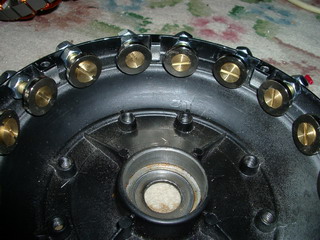

wow 200 watts for your conversion thats good, did you rewire it. I did this some time ago and used ring magnets, turned out to be alot of work and not much power for the fun. found some old pics.
wayne

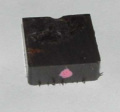

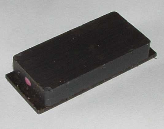

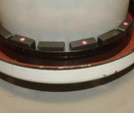

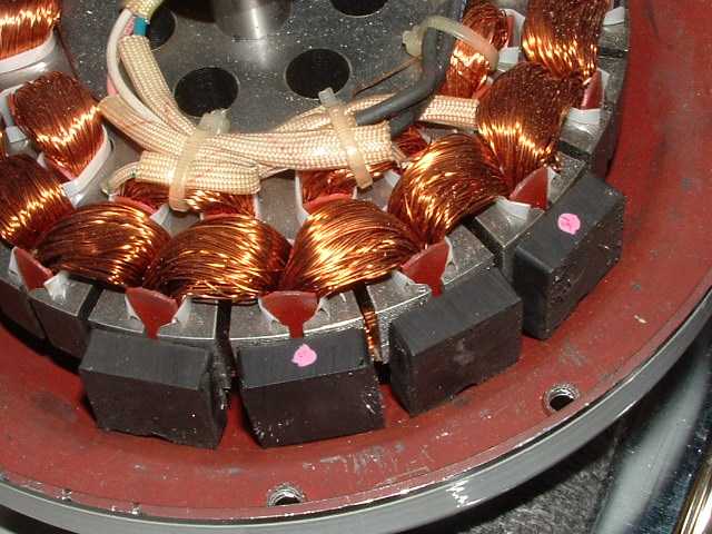

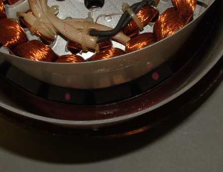

Here are some pictures of the process by which I converted the ceiling fan. The first two are of the ceramic magnets that were used.

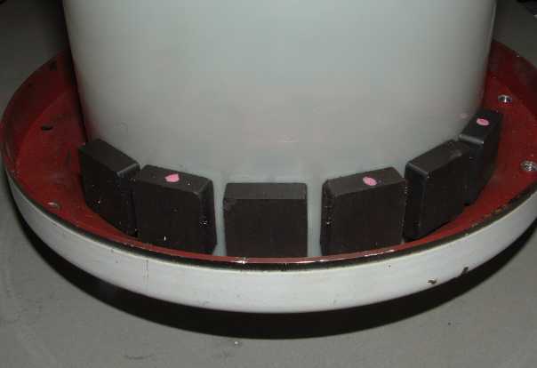

A pink dot signifies the North pole of each magnet.
I removed the backing plate, scored the magnet with a zip cut disk and then snapped it in two.
You can see the spacing of the magnets N,S,N,S.
The mylar sheet gives me the spacing needed between the core and the magnets. Five minute epoxy was used to seal the mylar film to the case.
A 20 cm steel banding wraps all of the magnets.
A poly outer ring is shown in place. I now poured the resin cast into the level mold. When the resin hardens the stator can be pulled from the magnet ring. The poly is also removed and silicone is used for securing the ringto the case.

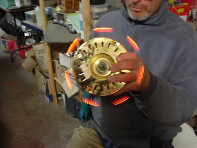

In this last picture my brother Bill is spinning a test model by hand. Using two magnets and two orange leds, he demonstrates the output.

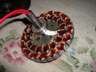

Excellent idea and your magnet blocks are better than mine. I had to lathe each brass bolt head to get close. It looks like you did not rewire yours, I did with mine and think it was #30 but don't hold me on this, would have to check again. Makes me want to crack it open again, winter is soon.
wayne

Wayne, you are correct, there was no need to rewind the stator. In tests with the finished unit at 600 rpm I was getting 124v ac at 60 hz into a 100watt bulb and 50watts from the other phase. Because the phases are 180 degrees out, I fed them into the primary of a 200 volt ct transformer. The transformer has multi output taps. I lose a little in the step-down but I have seen 200 watts ac at the output in a moderate wind. Also because the two outputs are 180 degrees out and one half the voltage of the other, I am going to try a phase shift ac regulator.
Joseph
