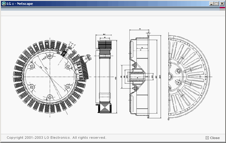

I know L.G do use this motor and what models for sure I don't know. I did look around and didn't find any L.G in the dumps in Canada. Here is a old pic from L.G
Wayne

that is great for showing photo of LG hubs and do you know what size is the shaft as l cant read that writing when l zoom the picture as some ago l saw LG washer machine at lifeline centre and ldidnt not taken any notice of it but looking for F&P and l will go back to few dump in my area if l can get one of LG part hopfully if is any luck if l get one I will post the news

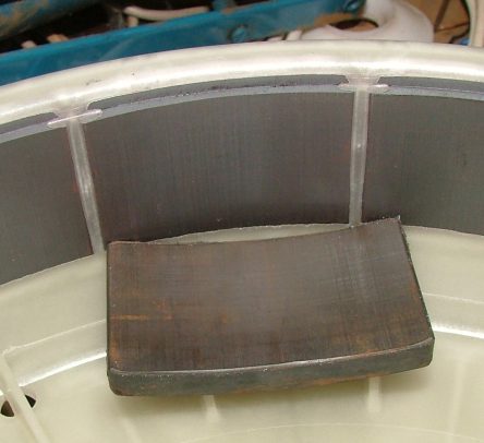

I took the hub back off, and counted the magnets. The olf hubs have 14 large ceramic blocks, each with 4 magnets, giving us 56 magnets. The new hub has 16 ceramic blocks, each with 3 magnets, giving us 48 magnets!
This means the new hubs are not compatible with the old stators.

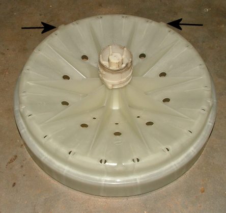

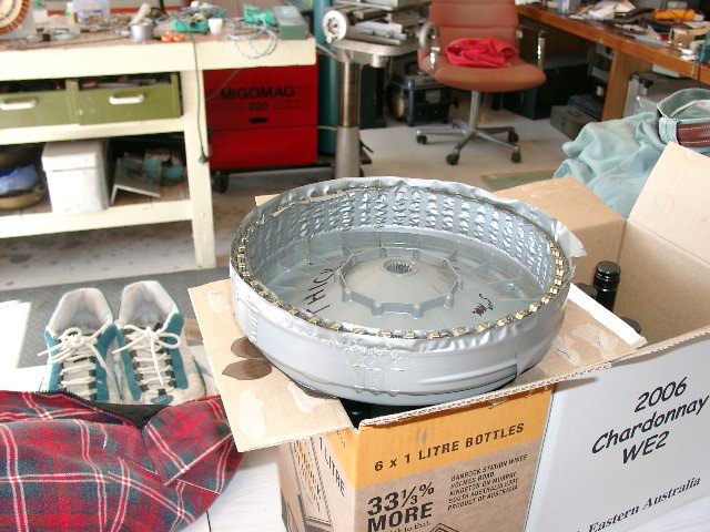

Posted: 09:51am 12 Oct 2006
Some photos.
From the back the hub looks identical, except there are 5 lumps, two shown with arrows.
And this is the difference in magnets. A magnet ( actually 4 magnets in one ceramic tile ) from an old hub is shown for comparison. You see the new ceramic tiles are shorter, and contain 3 magnets.

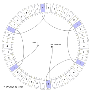

The old stators can be re-wired to suit, and it gives us a whole new combination of connections. I'll play around with these new connection options this weekend.

Buttttttt,,,,,   maybe the new stator has a more even amount of poles and therefore it will be easier to re-configure and more options????
That LG stator looks like it has 36 poles ,so it will let us have more combinations to work with

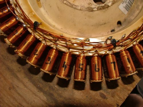

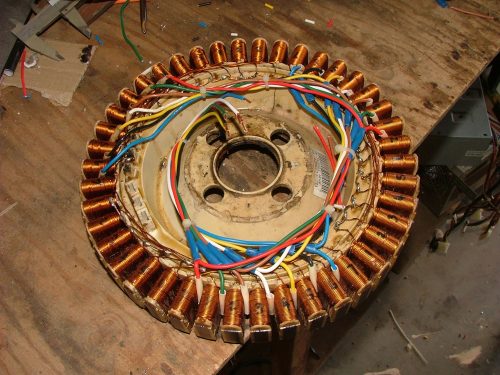

Posted: 09:31pm 12 Oct 2006
The hub cost $60, pretty cheap. I started re-wiring a stator last night, every pole coil needs to be separated, so you end up with 84 wires ( 42 poles ), then every 7th pole connected in series. Using this 7 phase configuration, we now have 6 groups, which means we can re-wire as 6, 3, 2 and 1 ( the old setup was 14 groups, which gave us combinations of 14, 7, 2 and 1 ).
Its actually a lot easier to re-wire than I first thought, and I'm pretty excited about its potental. This will give us a cog-less F&P, with 4 different wiring combinations. I'll draw up some wiring diagrams this weekend. The only disadvantage so far is because we are using 7 phase power, you really need to mount the rectifier at the windmill top, running 7 wires down the mast would be a problem.

Posted: 11:22pm 13 Oct 2006
It works.
Wired up a stator for 7 phase, its a standard stator, 0.8mm wire, not decoged. Built a 7 phase bridge rectifier. Bolted it to the Lenz windmill. In a slight breeze I was getting 6 volts per phase, all phases equal. No noise, no cogging. Connected up the bridge and battery load, wind picked up a little and read half an amp into the battery.
I've connected up the PicLog and will record the watts over the day, but it looks like its a winner. A cogless F&P.
Its a series connection, so each leg of the phase has 6 poles in series. Later I'll re-wire it as a series parrallel, 3 of 2 in parallel. Then for the real test I'll take down the big HAWT and fit the new stator and hub.
