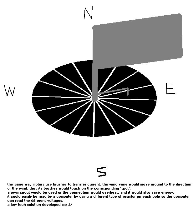

makourain
Joined: 19/04/2006
Location:
Posts: 111
Posted: 05:55am 15 Oct 2006
the image is by now means how i would put it together but it illustrates what i am trying to say Edited by makourain 2006-10-19

  sangeff said   Im in the middle of building a weather station and the wind vein will use a home made binary coded disk, 4 photo switches from an old brother fax machine and a 74/154 4 bit binary to 1 of 16 decoder chip that is now available as an 74LS154 , (check your altronics catalogue)
Suggest VERY strongly you don't use a binary code. Binary code may have multiple transitions trying to happen simultaneously - of course, they won't, and you get all sorts of bizzare things happen.
Use a "Grey Code" instead, if you want a digital output.
Alternatively, my professional Davis Instruments helicoid propvane uses a 360 degree "potentiometer". Ground on one side, excitation voltage on the other, and the wiper is between 0% and 100% representing 0 to 359 degrees.
In my own weather station, I simply read the analogue voltage, converted (ratiometric conversion) to degrees, and then added a constant for calibration and modulo 360 for the result. (Why do this? Well, it's a DAMN site easier to point the thing in a known direction, read the position indicated and apply a correction that then works across the board, than trying to climb up and down the tower tweeking the thing!)
