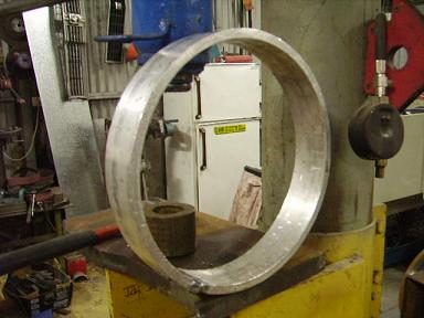

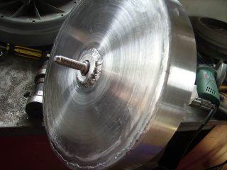

Just last night l just finish Fabrication the First F&P Alloy Hubs and is alot work and got three more to go and hoping will finisih in next few more days .
l going place some photos sometime tomorrow for everyone to have alook and let me know what you think ? or

Good stuff Dwyer--- Trev Richards has built a model and I will get one of his soon. I suggested he bore it out to fit the F&P shaft and mill a keyway in it --that way we can adapt it to different shafts -He also is milling the spline into his hub.
I,ve found the plastic hub internal spline is getting a bit "tired" after I've placed and removed it many times--this should not be a problem with your guys metal hubs.

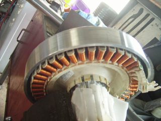

Here's Dwyer's photos.

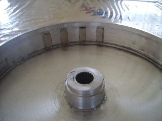

Very nice work D . wonder,are you going to insert a steel band on the inside of the rim??
Helps when placing the mags-they stick nicely .

l have roll of piece of the flat steel band is 1.2mm x40mm on the outside of hubs so magent stay on while l taking some photo and at the momest l am trying to work how many magent will go on and there are 2 off 3mmx12mmx20mm and might have to order 6mm thick instead 2 x3mm .
Many thank to Gizmo for helping me load the photos as l had some software problem on my computer
