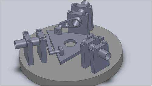

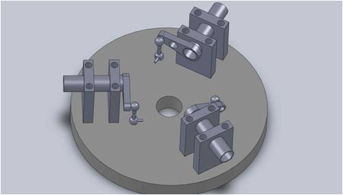

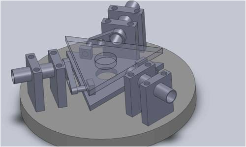

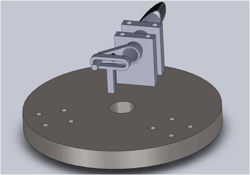

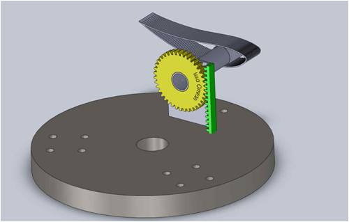

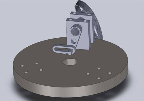

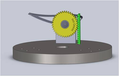

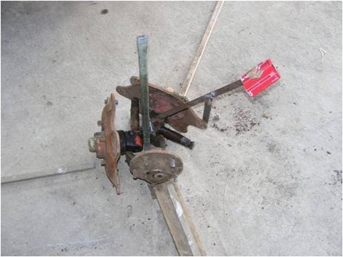

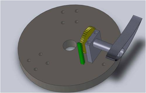

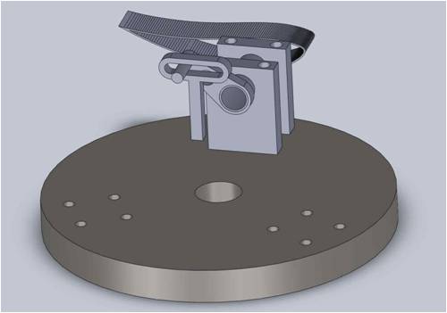

Variable Angle of attack or pitch control
First I would like to ask all,
Is it better to start a new post or is this location good enough.
What is best for these blades? Variable angle of attack system or fixed for a 3 meter per blad by 3 blades windmill. Since I want to make one that is 6 meters at least.
What do you all think?
Here are some pics of different angle pitch control systems. What do you think?
I like the pinion and gear system but I need the calculations but also it needs something to back up the rack, I also like the? Scotch Yoke Leaver system simplest also has self limiting property.
I still need to do lots of math/engineering. Any help there?
Please all comment

Hi udsn
The scotch yoke in your last picture is the simplest to do, but is better with a round pitch plate than a triangle as it is easier to combine into a governor system. However the engineering of a device such as this would require a machine shop and the skills to use it otherwise the cost would be to great.
For our size mills it is better to stick to something simple like a furling mill or even a high speed non furling mill, if you are thinking of a multi KW mill then the pitch control may be a proposition, but will be a high maintenance device.
KISS is the word.
All the best
Bob

Hi all
Thank you all
Thank you and hi both Rastus and VK4AYQ
The Scotch Yoke is the first three pics.
I am working (theoretical) on 5 Kwatt system 6 meter long diameter. I only have the
aluminum blades.
What do you mean high maintenance? Why?
I think the best to lower maintenance is the ball joint system.
Something that is engineered for outdoor use in the first place. for dust ,water, extreme conditions, also ready off the shelf.
Do I need a range larger than 90 degrees?
What is the optimal for GOE222 ??
Best regards
