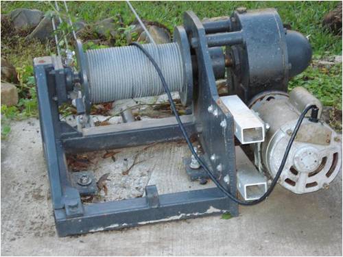

Hi Crew,, My tower has been down resting for some months now ,while I play with other things and my new Exmork gennie. Have to beef up the steelwork on the tower a bit.
Anyhow yesterday I decided to raise the tower to check for maintenance issues.
Yep, the electric motor stalled ,just hummed a bit ,but started when I spun the uni joint a bit ..
ANTS, millions of them inside the motor , I think are the problem , so, I'll have to dismantle the motor (bugger of a job) and clean her out..
So, just a warning to those of you that have electric motors attached to things near ground level,, keep an eye on them , --I had mine covered with a tarp --

Hi Bruce
The wet weather has them looking for a dry home where they can, might pat tp commect your battery charger to the motor to dry it out a bit before running as I had one loose the magic smoke yesterday due to moist windings.
All the best
Bob

OK, thanks Bob ,, she growled a bit , but I didn't persist for more than a second .. I reckon ,or hope, it's the ants ,, hell of a job taking the motor off , nearly a 2 man job , heavy ,and those holding bolts are in that channel , a bit tricky to get them in ..

Hi bruce
Try leaving it mounted and take off the end plate of the motor to clean the end out and use compressed air to blow the ants nest out, make sure the start run toggle relay isnt stuck as well, dry out with a battery charger apply a liberal spray of CRC et al and plenty of surface spray for insects as the little buggers will come back as soon as you turn your back.
All the best
Bob
Bruce that is the symptoms of a bad capacitor.
Allan
Posted: 11:24am 24 Jan 2011
Yeah Bruce I agree with Allan, sounds like a bad starting cap. Even full of ants and their nest, the motor should have started. Mind you, ants and dirt wont do the motor much good once it was running
At my old place there was a 2.2kw single phase motor on the jet pump, to pump water up the hill to the house. It was a on demand system, with a pressure switch. Over a period of about 2 months, I noticed the water pump wouldn't always start, getting worse with time. Up at the house I would turn on the water tap, and as the pressure dropped off, the lights would dim as the pump tried to kick in. After several attempts it would start and I had water again. There were two motor start caps, a 8uF and 4uF in parallel to give 12uF. My cap meter measured about 7uF total, so I bought two new caps, and they measured the correct 12uF. Fixed the problem, the motor started first time every time.

Thanks for that info Alan and Glenn and all others ..
I'll change over the cap and clean out the ants ..Hope that fixes it .
