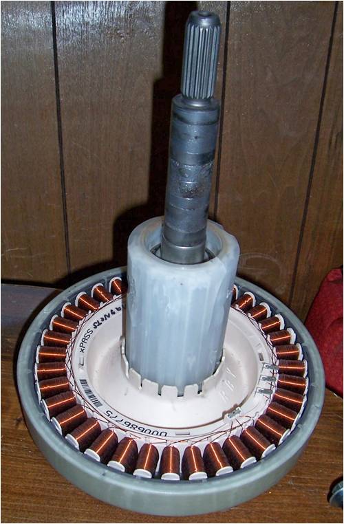

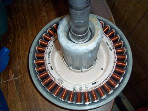

Hello all,
I reworded this post. and resubmitted.
stator I purchased from the states.
It has 36 poles with a count of 16 magnets.
I mic. the coil wire its .023".
Can Anyone I.D. what motor this might be.
what would best suit output configuration.
I'll try and upload picture.
The staggered stator arrangement looks like a winner for
my 12v system. My prop diam. 51" 5 blade.
We have good winds here.10 to 20 regularly.
After reading the staggered stator articles. It sounds right.
for my application.I read of the 42 pole.
Could someone advice to combination, best suited.
1 of 5 & 3 of 7..... or 1 of 4 3 of 6..
have no idea to wire resistance ect..for rewire.
I do have 2 large rectifiers which will probably be mounted up
on mast.Originally after posting about distance, was going to bring
it down as a/c which I agree with response that it was better to rectify
at house. But would have to run 3 more wires to inside through conduit.
Thanks for any suggestions as I have been testing furling and tower
with a 30v Ametek, which I'm satisfied with and now ready for F & P.
Thanks,
Chuck

Hi Chuck,
I'll stick my neck out and say it's a third generation 60s F&P unit,reference info w.w.w.ecoinnovation.co.nz under the category of Manuals.The reason for this claim is the F&P 60s wire diam. is aprox .6mm/.024" close enough!
cheers Rastus

Hi Chuck,
I think it's a second generation 60ss F&P,taking into account your round pole note!The round poles improve the motor by reducing "cogging" so the rotor runs feely.For generators this is a significant feature.The blades should turn in the least amount of breeze.I havn't seen 1,only read about them.As far as wiring options for 12v,I'd consider matching it to your 5 blade rpm range.I'm also hoping this post will increase traffic and assistance for you! cheers Rastus

Hi Chuck,
I've noticed the terms I've used are confusing ,so to clear things up, the 60s(series) are the F&P third generation motors.The round poles are classed as a 60ss F&P because of improvements.Becoming a 60ss(series second) stator.The coil wire size for both is the same.Matt's advise on wiring selection comes from practicl exsperience!You won't better that.Cheers Rastus
