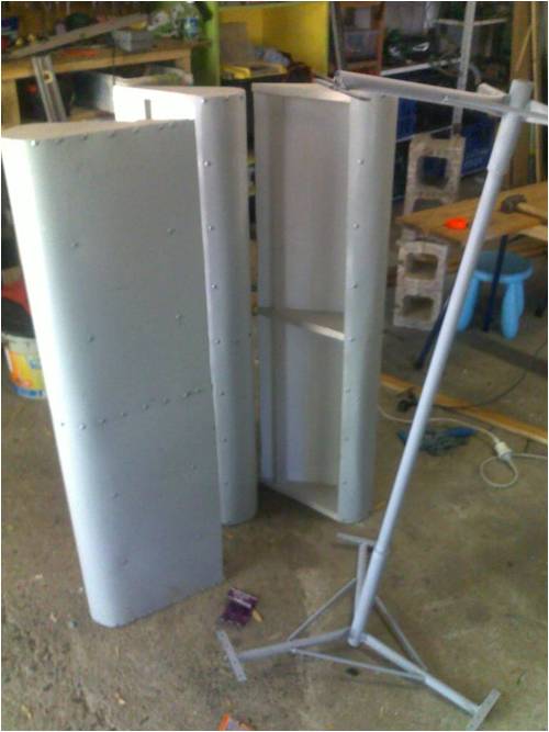

I have built a Lenz2 turbine on a F&P motor (i basically went for size and dimentions that were about the same as others using the F&P set up)and I am now trying to sort out the electrics.

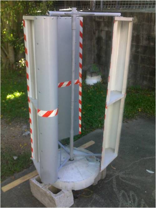

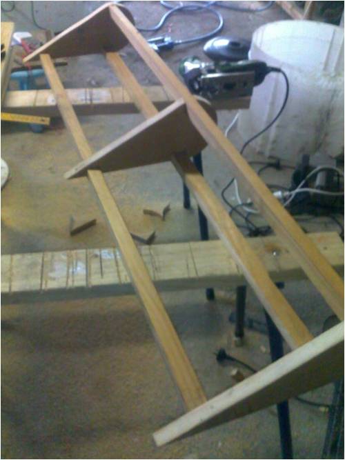

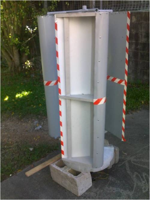

Some pictures of my Lenz2 being built..
