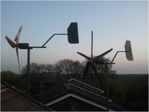

I have 2 tread mill motor mills on a good day they are fine charging my batteries low wind days not so good.
Can i link them in series how would i stop one from driving the other any tips

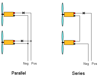

Yeah you can connect them in series. These are DC generators, so connect the pos of one to the neg of the other, and you will get the combined voltage from both. Your current will be donwn, but a little current is better than no current. You only need one diode to stop them been driven as fans from the battery bank.

I tried putting a 30 amp blocking diode in still tries to run one as a motor i.e
First motor pos to neg with a diode but still tryes to run the second in reveres neg to pos
Go to try a bridge rectifier in see if that will stop the voltage running back into the second.
Using 2 due to homemade blades run very well to 11 v each
if you use two blocking diodes stops the circuit tried one on each pos leg and one on pos and neg leg problem is as a dc motor it will run in reverse
any more tips must be a way

In a parallel set up, which sounds like your existing set up, you would need two blocking diodes, one for each motor. For a series set up, only one would be needed. A blocking diode drops approx 0.6 volts, so the less diodes in series the better.

Thanks for the info i will look into this i have it working with 2 bridge rectifiers dc in dc out rather than ac in dc out my loss is about 2 volts on each genny
