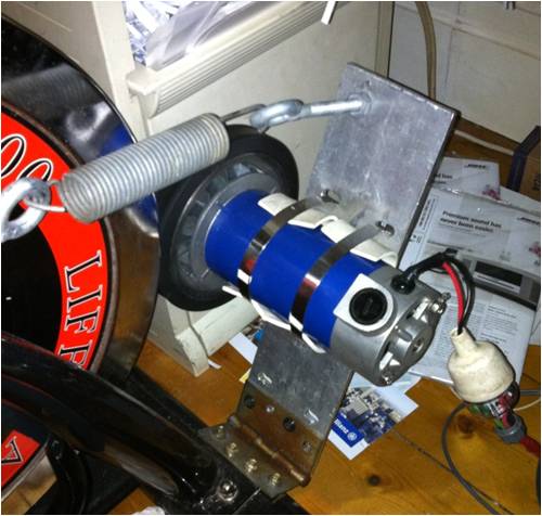

Posted: 01:50pm 10 Jun 2011
Hi Paul,
I'm not expert but your calculations sound about right.
My treadmill motor has the same specs as yours. Mine says it is a 5amp motor.
I have one hooked up to a spin bike. See the photo.
It is connected to 12 volt deep cycle batteries with a charge controller that keeps input at 12.4v approx and won't let it go higher no matter how fast it spins.
I can tell you in practical terms what it puts out.
To get it to generate 12 volts it needs to spin at minimum of 456rpm. My amp meter shows no amps or close to 0.
To get it to generate 12 volts and get it up to 2 amps it needs a minimum of 720rpm.
This is achievable on my bike because my cadence ie rpm of my pedals is usually 80.
This gives me an rpm of the generator of 960rpm.
ie 80x 3x4. ie 3 rotations of the bikes flywheel for every one at the pedals.
The treadmill fly wheel spins 4 x for every 1 of the fly wheel.
The minimum required to get to 2amps is 60rpm at my pedals. so 60x3x4 is 720rpm
I know the amps because I have it connected permanently to the bike.
