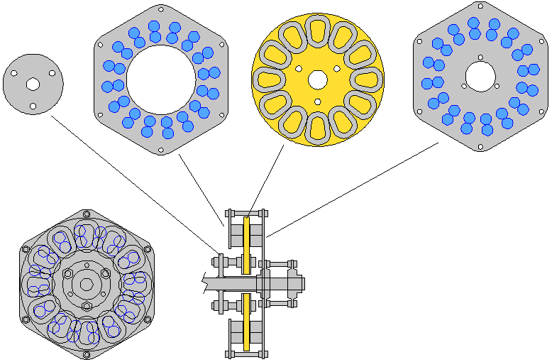

I've been drawing up plans for a small axial flux alternator. I was inspired by recent posts about the price rises in rare earth magnets, and Hugh's comments in this thread about the advantages of ceramics compared to the more powerfull rare earth magnets.
My last axial flux build was based on the 50mm wide 12mm thick rare earth magnets. Its unfinished, cause it weighs a tonne and I've got nothing big enough to drive it, it can wait till I get some land and can put up a big turbine. Here's the thread about that build.
I searched the magnet suppliers to see what was available in ceramic, and found this little ferrite magnet, its 22mm diameter, 25mm high, 1800 gauss, and $1.10 each. Of all the ferrites, its one of the strongest for its price, due to its long length. So I've ordered 64 of them for the planned axial flux alternator. I'll use two magnets side by side to give a 44mm by 22mm wide magnet pole. As the magnet is narrow, I can fit more magnets and coils around the diameter. Instead of the usual 12 magnets per side / 9 coils layout, I'm using 16(32) magnets per side, 12 coils. More magnets/coils means a higher AC frequency, so more power than a lower magnet/coil count. Plus 4 coils per phase means its easier to wire a stator for 12/24/48 volt operation.
While I dont expect anywhere near the power of rare earth magnets, I can see some advantages to using this layout. The magnets are very cheap for their power. 1800gauss for $1.10 in ferrite, the same size magnet in rare earth is 5780 gauss, about 3.2 times stronger, but is worth $22, 20 times the price. Since we are using a weaker magnet, we can use thinner magnet plates, 4 or 5mm instead of 10mm, saving more money and weight. Its also a lot cheaper to get 5mm plate cut than 10mm plate.
So by using ferrites we end up with a alternator about 1/4 to 1/3 the power of its rare earth equivalent, for something like 1/10th the price. We also have reduced the weight, and have a alternator that will run cooler and should be more reliable. Plus ferrites dont rust.
This is a basic layout, its using the same design as the bigger axial I was building. Diameter is about 260mm. Using two pillow bearings instead of the wheel bearing, the 25mm shaft is fixed.
When the magnets arrive I'll test them on some 4 and 5mm plate to see how thick I need to go to go, ideally the back of the magnet plate should have almost no magnetic field radiating from it. If a nail dont stick, its OK. Then I'll get the plates cut and go from their.

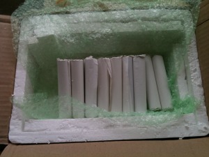

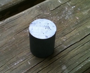

Posted: 03:13am 09 Jun 2011
The magnets arrived today.
Well packed.
One of the magnets.
Also in the box was product catalogue leaflet, a fridge magnet and a information sheet that covered some interesting tip's, like how to separate the magnets, what they are made of, etc.
Pretty happy with the order, top marks to aussiemagnets.

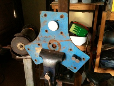

Posted: 12:42pm 09 Jun 2011
I stuck the magnets on some 3mm plate. In the pic you can see a single 50mm neo N50 magnet and two of the ferrite magnets side by side.
I wanted to see how much flux was leaking out the back of a 3mm thick steel backing plate, and if I could side two ferrite magnets side by side without them pushing apart from each other. They would sit side by side ok, just. A drop of superglue underneath will help, but I also think a cable tie around the pair would ensure they stay put.
I used my gauss meter to take the measurements. The max gauss my meter can read is about 1500, so it was pegged out on the faces of both the ferrite and neo magnets. Reading the back of the plates was interesting. I could detect 23 gauss behind the ferrite magnet, and its a 1800 gauss magnet, so less than 1.3% is lost. What was surprising was the neo magnet, with a reading of 124 gauss. At a guess its a 5500 gauss magnet, so I'm loosing only 2.3%. I'm thinking the 10mm thick plates used on the larger axials might be a bit of overkill.
Anyway, I'll use 3mm plate for this prototype. I may gain a fraction of a % in power if I use 4 or 5mm plate, but 3mm plate is much cheaper and easier to cut. I think it will have more than enough strength too. The 23 gauss wasn't even enough to hold a small nail to the back of the plate.

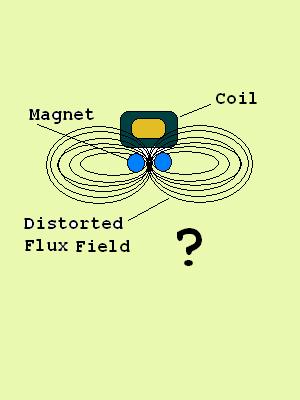

Just Curious whether this would effect Inductance?

Both magnets are facing the same way, not opposite. N to N, S to S, so it becomes a single larger figure 8 shapped magnet. If they were fitted N to S, yeah, it would cancel out across the coils and you'll get no power.

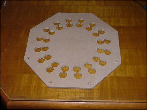

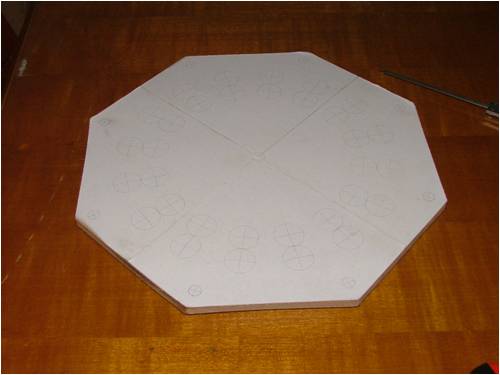

This morning I made the magnet locating jig. Printed out part of the cad drawing at full size and cut into sections, it was too big to fit on one sheet.
Lightly glued in place and then center punched the holes. In hindsight I didn't need to glue at all, some tape would have worked, just to hold the paper in place while I center punched the holes.
Finished jig, holes drilled. The magnets are 22mm diameter, and I just happened to have a 22mm wood bit in the tool box.
Next up are the coil formers.
