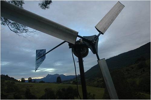

Team thanks for the inspiration and advice, she flys !! The 7 phase rewire seems fantastic, I can't give you any numbers yet but it starts up in a very mild breeze and is CRUNCHING amps into a 12 volt truck battery as I type.....

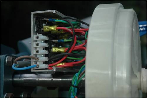

The 7 phase full wave bridge rectifier sitting behind the rewired stator, yeah, that wiring is messy alright !!

Nice work OMM, looks well put together.
My 7 phase conversion worked pretty good too, it was one of my best performing mills. Good to hear its working well for you too.
Nice view you got there.
