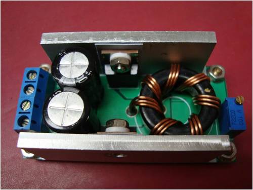

I have a mill from a DC treadmill motor, the voltage is a bit low, so my question is this:
Is there an adjustable relay available, something like a dump controller so I can put a couple of DC voltage boosters in line, so if my mill is producing 6-7 volts I could boost it to 12-14 volts, and then if the mill puts out more than 12volts I could boost it to 24-28volts via a second booster, if you know what I mean, quite hard to explain in words, I'll try and do a drawing to better explain my idea.

the normal little boost modules will do that, I would suggest a 3 amp one that cuts in at 5 volts and a 9 amp one that cuts in at 10 volts, but I suspect you won't get much from the higher one unless there is a cyclone.

Those modules look just the job for my mill.
