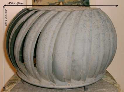

Hi peoples,
Absolute newbie to this stuff.
I just posted on otherpower.com a full outline of what I'm trying to achieve and why, so I'll provide a link rather than rewrite the hole topic.
http://www.fieldlines.com/story/2005/10/14/92732/876
Put simply, I'm contemplating using this 460mm x 290mm whirlybird turbine........
...to drive an F&P mounted on a 450x450mm x 300mm(H) box for use as a portable genny for beach camping. All electronics in the box including 12v outlet and 150watt 240/12v inverter outlet, 120A sealed wet deep cycle battery in it's own plastic battery box to sit along side it.
I plan to do some heavy decogging which I know will cause power loss, but I believe I need the turbine to start spinning at low wind speeds.
My power needs are a constant 5.5A full time for a 12v fridge, and a couple of 240v 8-11watt fluro globes, plus a few other items that will draw around 4-5A in total for 1-2hrs a day run from the inverter - it draws .1A.

Well I read the above, and the other info on OtherPower.com. It can all be done, but.....
Your going to need a bigger windmill. The F&P makes about 1 watt per rpm, so for normal use we expect about 200 to 400 watts for a HAWT windmill, and over 1000 watts for water wheels. EcoInn ( see the links page ) has a lot of info on the F&P for both wind and water use.
My windmill is 2.2 meters in diameter, so has a sweept area of about 3.7 meter square, and that gives me 20 amps peak into a 12 volt battery, or 240 watts, when its blowing a gale. On average I get 10 amps, or 120 wats.
VAWTS are almost as efficient as HAWTS ( see ED's new design ), so you would need a VAWT about 2 meters high and 2 meters wide to get the same sort of power. See where I'm heading? Your little wirly bird just wont have the power to drive the F&P. Its a good idea, but you need to go bigger. Why not build your portable box with the controllers, inverter and batteries, and buy a 200 watt windmill from Oatley Electronics for $499 AU. It come with a simple tower and would only take 30 minutes to put up.

I totally agree with giz, you will need to go alot bigger or only go to the beach when there's a storm.
The whirly bird will not come close to even starting a F&P gen.

Thanks guys,
I tend to agree with you now - I took the turbine outside and sat it on a bucket in a good stiff wind, it was real easy to stop with a bit of hand pressure.

Hi greg.  I tried that whirly exhaust fan years ago -got the biggest one  from the manufacturer -damaged,for free. I sat it up around 40 feet with a small belt drive(printer ) and a small pm 12 v motor.
In a stiff breeze it barely moved and as soon as I shorted the leads it came to a sudden stop -- So, sorry,but they won't work.
