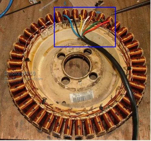

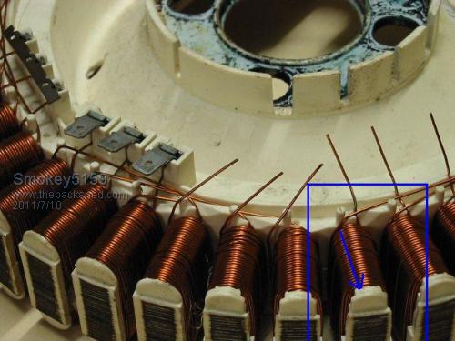

Mate, I am pretty mechanically minded, and understand a lot of what I have read in the project section. Is it ok with you though if I get stuck to quiz you now and then? Like my first question - where do these wires attach that disappear in-between the stators?
And where it says... "I found if I unwind the outer coil one turn, it was then long enough to reach the next coil, 7 poles further around the stator".
Does that mean fully unwinding a whole stator pole's length of wire, or just one turn?
