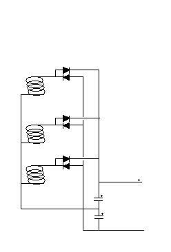

Highlander, this is a way of doubling the voltage (and incidently avoiding one of the diode drops, I think). Through one half cycle one capacitor is charged and the other charges on the other half of the cycle. The output voltage is the total of both capacitors.
The two capacitors could be two batteries of the right voltage.

Voltage doubler, yes... but crap performance at any non-trivial current, and you have to use very large capacitors - and caps of that size generally HATE the high ripple current they are required to pass in this mode.
Sorry KiwiJohn - but not practical in this instance.
Overall, be much better to go high voltage then use a switchmode downconverter. That also significantly reduces your copper losses on the run from the mill to the batteries.

This is what I had in mind for the rectifiers.
PS I'll set up for 44 magnets unless someone has any bright ideasEdited by Highlander 2006-12-13

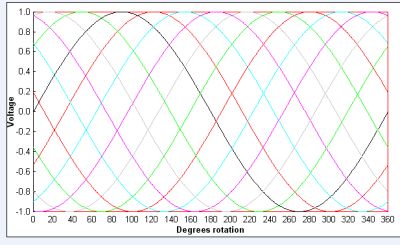

Megawatt Man, Highlander I even sat down today to try and draw the combined waveform of a many poled machine and needless to say it is really quite smooth. Not only are the peaks close together but the peaks are actually quite flat. 21 poles was too hard to plot but here is 11.
Considering how flat this output looks I think it would be interesting to try variations of the voltage doubler circuit I drew earlier.

Yes, it works on batteries because they are a continuous source of supply
If you look at the circuit from an AC perspective, on one half of the cycle you get current flowing through one diode (and nothing through the other). Then, the ac cycle goes the other way, and the negative half cycle goes through the other diode, and nothing through the first diode. So without the capacitors, you would measure *NOTHING* from cathode of one diode to anode of the other because the + and - are never there at the same time.
This is where the trouble comes in - in order to "carry over" each half cycle, you need a capacitor to the mid point. But that capacitor then has to deliver the power while the opposite half cycle is charging its cap and delivering power. The lower the frequency, the longer these caps have to hold up for.
And as we all know, the energy in caps is limited - the more current you pull from them, the quicker they discharge. So at "reasonable" currents, these have to be VERY big caps.
But that also means there are lots of amps in the discharge half cycle, and lots of amps when they recharge again, so the "ripple current" is huge - which large caps generally don't like.
So please don't take my comments to heart, you - or kiwijohn - I wasn't trying to teach anyone to suck eggs, just pointing out that what "looks like it should work" in theory more often than not doesn't translate.
