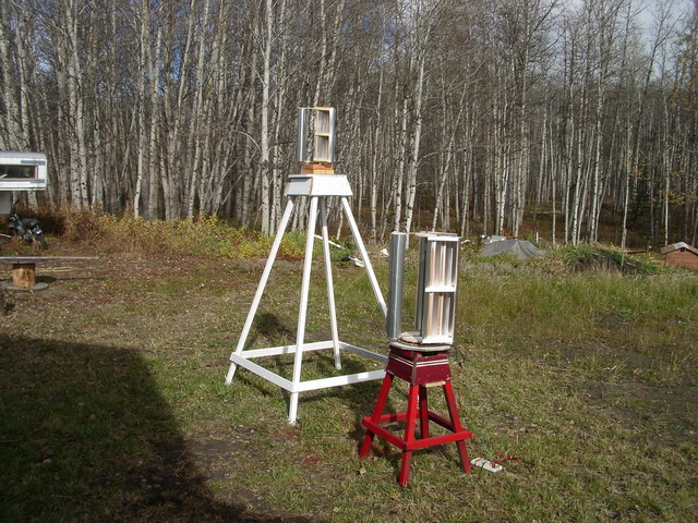

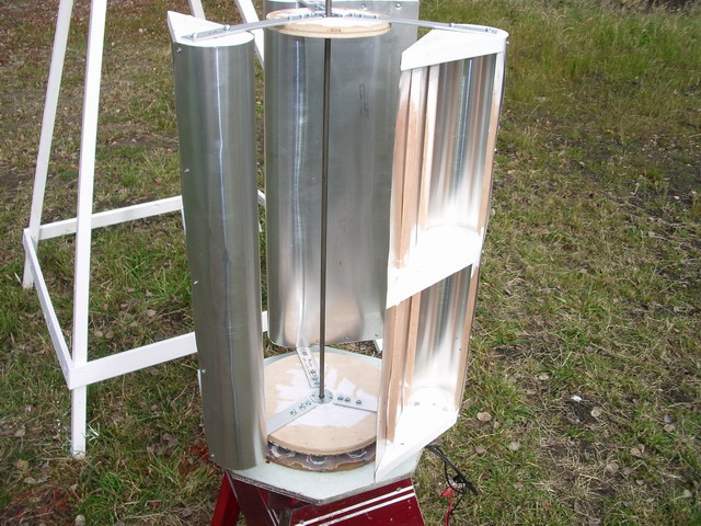

This is my first post and built 2 units. The little one on big stand just free runs, but the bigger one on red stand has 16 mag, 12 coils. Haven't really spun it up yet, but get about 2 volts by hand. The spacing is off and having real problems to find a solution to bearings. Thinking of now 3/4" shaft and just 2 bearing supports at bottom, or should I use top/bottom plates with bearings. And what bearings are the best for a VAWT. Went to auto place and got the real run around as sizes, types, loading etc. Just don't know. Any help please.
note: one in pic is 5/16 shaft and roller bearings
Thks
Wayne
Alberta, Canada
Posted: 05:18am 20 Oct 2005
Hi Wayne.
Yeah I think your going to need a bigger shaft. What about some 1 inch gal water pipe?
I've used the 56205 bearing for a few of my windmills and it works well. The bearing comes as 2 parts, the bearing and carrier.
These go together like thus....
A couple of these will hold a 1 inch shaft well enough for your windmill. The VAWTs need a strong shaft if they are not supported at the top.
Posted: 05:19am 20 Oct 2005
Nice looking mills, by the way.
