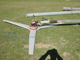

I decided to give my trusty dual f&p a tidy up its been hummin all winter and the blades needed a little new paint on there leading edge and when I put it up I only used the old berings that were in the washing machine so I thought its about time to have a looksee it was still going fine and i have been very happy with it.
was bringing it down slowly it got about half way and....
DOWN IT FELL

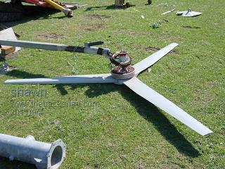

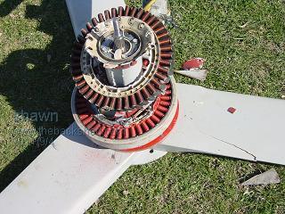

Damage was two broken blades two broken stattors bent shaft (i think) broken tail and there was a lot of noise pollution, short four letter words just flew everywere!!
Lerning curve is still growing, another dead mill to add to my big pile.
Reason for death
When I first put up this tower I had no power and had to cut the guy ropes with a hacksaw those of you that have done this no that its hard and no fun, in my wisdome instead of cutting four guys i cut two double size and went through the guy point around the tower a couple of times and down the other side thinking that even if the guy point failed it would have to pull the tower in half to fail and my welds might be a weaklink so this would solve any posible problems, it worked fine for ages then in my wisdome i desided to make it a tilt tower rope sliped through when under the most strain.....

Its from these events we seem to learn best Shawn, I bet your resurrected windmill will take the strain .
For what its worth - and I learned that the hard way with antenna masts - its easier if a fixed permanently upright pole (or one at each side) is placed near the windmill mast and the windmill mast either hinges at the base or see saws from the additional pole(s), The poles are about half the windmill mast height. Using these to lower the windmill lessens the load on the tackle or winch considerably.
