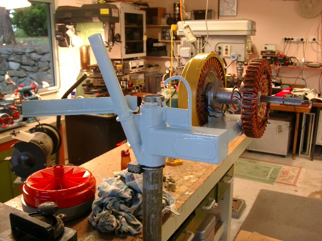

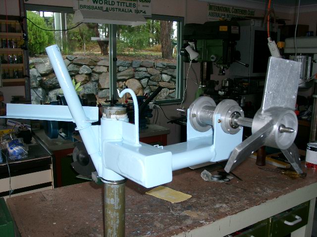

I've sort of finished my new direct drive platform apart from fitting the blades to Trev,s blade hub. In the pic you can see Trev's cast bearing holder and modified spline(extended) on the s/s drive shaft.
This bearing arrangement allows for 2 stators and rotors to be fitted on the single shaft,maybe I can off-set one against the other to sort of maybe cancel out the cogging, we'll see.
Bruce

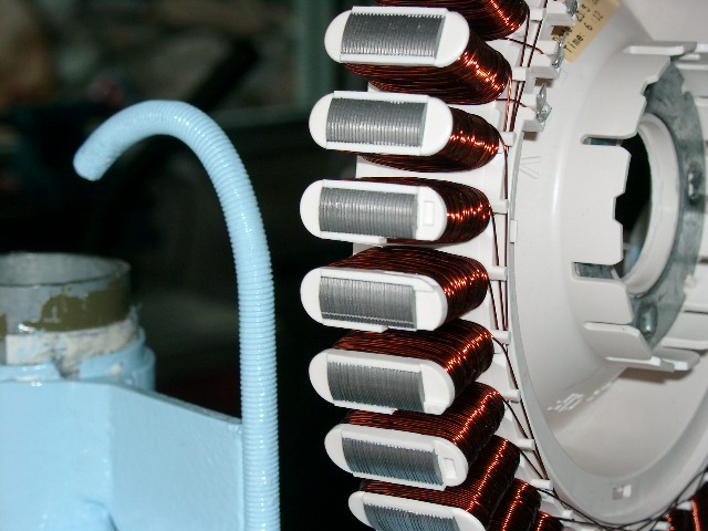

Very interresting looking stator, those curved pole ends have got me a little worried. The new stators have less poles, and curved pole ends, so there is a chance these may make less power than the old 42 pole stators. However, the fact they have virtually no cogging is a big plus. It may end up these are suitable for low wind startup, low power windmills. I can see I'm going to have to get one in and have a play.

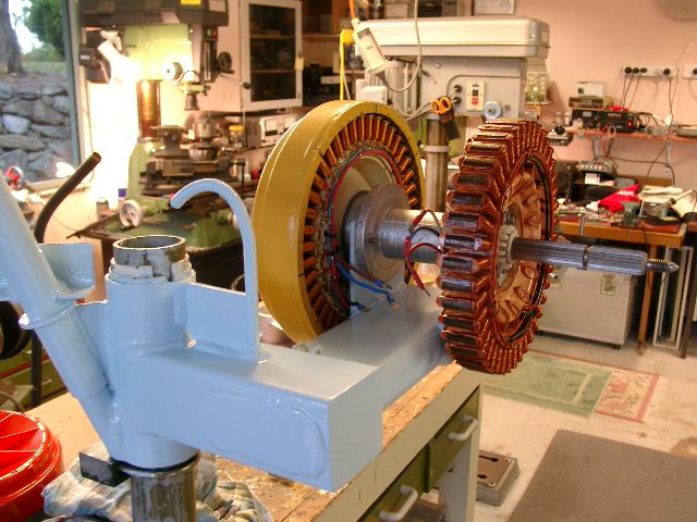

This is the new set-up. Will try fiddling around with the thing today.
By the way , anyone (Trev) got any idea of making a tool to place and remove one of these rotors ,when the special nylon nut is not used. ?. On the dual rotor set-up you have to remove it (special nut) .
Bruce

Sorry Bruce I wasn't suggesting putting an old and new on on at the same time. I was trying to get confirmation of my calcs that for old hub you have 1/4 of a turn on splines for adjustment before your back to the same cogging force. (1/2 a rotation of hub on new type). I frequently confuse myself

G'day Bruce, that new platform looks pretty flash. If I ever get around to making a second mill I'll copy that if you don't mind. What's the bit of angle on the tail shaft for? I'm assuming it's to do with furling.
As for removing the hub after the fp nut is removed you should be able to make extensions on a 3 jaw gear puller or make one from scratch. It appears you have every tool that was invented, nothing like my collection so you shouldn't find it too hard.
PS that shaft Trev made looks nice, have you got a close up?

With my double White Pointer, I align the poles of the 2 stators. I have North magnet on one motor and South magnet on the other motor. I think its the best for minimising the cogging.
Removing the magnet hub with no nylon nut ( the one at the front), I just pull it off with my hands. I guess if you have a neo conversion on there, then you probably will need to have something to assist removal. A modified gear puller should work fine.

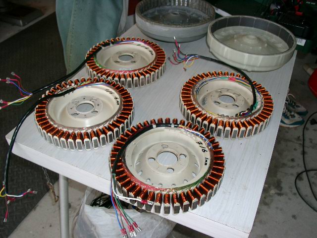

sorry ive been away so long but building a house takes a lot of my pleasure time away. I have two twin stator units made now and a mate of mine is going to be the crash test monkey for the first one. I will see him tuesday and will take photos of the unit up and running. I originally built a 4 stator unit but it was way to heavy for me to work on. I have since got a hold of an old galvanised telegraph pole that is 8 mts long, i concreted it into the ground 1.6 mts and will need to finish it soon as we are moving into the house early feb.

Yeh thanks Glenn, i have looked at the various twin and quad stator setups and found it best to separate the magnet rings at least 75 to 100mm. I found that the rings seem to "bother each other" but can not for the life of me work out why, you see the canadians and their magnets are very close but those units are not based on manufactured motors. the single unit up in the air for the last year has been regularly giving between 12 and 20 amps in 14 pole star has run the fridge 24/7 the TV when i watch it at night and all the compact flouros, but the windmills best achievment has been the total recharging of all of my Ryobi 18 volt battery drills and saws, this house has been built using the power of the wind. We will move in in early feb and i believe 2 twin stator units backed up by a bit of solar will run a carefully controlled remote power house. i have lived in the shed for the last 9 months and have never run out of stored wind power. Even more interesting is the total size of my current storage bank is made up of only 6 trojan 6 volt T105s, wired in 3 12 volt banks of 2 batteries each, these things are unreal and were given to me by denron metals, i have to look at some 12 volt marine deep cycle batteries out of a container freighter they are about 3 foot by 2 foot by 2 foot as told to me, i will let you know how they go. have a good new year.         & nbsp;
