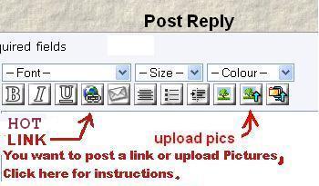

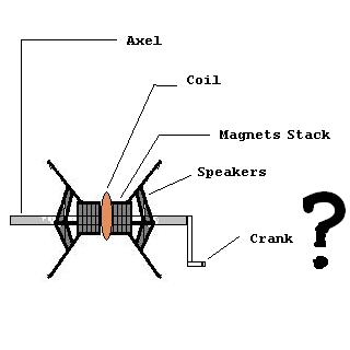

It's difficult to picture what you have, this is what comes to mind for me so I know I must be missing something.? I have included a little help for Uploading pictures,
Remember only JPEG or GIF picture format will upload to this site,, and Pictures should be cropped to the subject view, this will hold a better resolution when the web site re-sizes your pictures.

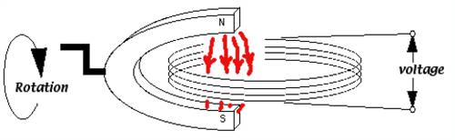

Here's another picture of a similar situation, but not as simplistic:
In this examplle, the magnet is "diametrically" magnetized.
Study this some and try to modify what you've constructed. Be sure to use a volt METER to measure your electricity production. It won't be much. A meter is absolutely necessary to view it.

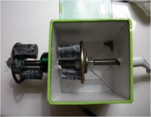

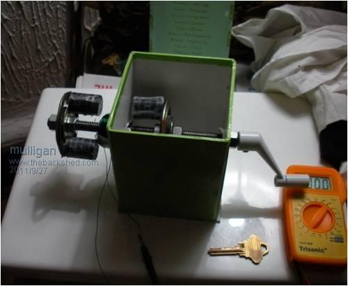

Good looks, fellow backshed members. Your timely and detailed responses are encouraging, especially in my frustration. Here are a few pictures of how it stands now,
The magnet-stacks on the outside speaker are both south side faced out, the magnet-stacks on the inside are north side faced out. Is this the way to do it? Or have each speaker with a N and S magnet facing out and align the two speakers accordingly? I will make a coil with at least 500 turns and make the inside diameter of the coil bigger. With so few magnets, will it help to have more than one coil? If so, do they need less turns? And when I connect more than one coil, do I just connect them in parallel?

OK, looking at the photo, is the coil around the threaded bar, or out to one side?
If its around the threaded bar, then the wires are in direction of rotation, so the magnets are passing along the wire, not across them. As Mac pointed out above, the magnet needs to pass over the wires at 90 deg to the wire.

nice machine !...pics are working fine
mini axial alt then ..
maybe a square bigger coil that has it legs directly between magnets would work better
(or) wind a mini coil that fits directly two poles ...
as you look at the pic each mag pole should be

The coil is fixed to the outside of the cardboard box and DOESN'T rotate when the threaded bar is rotated. I essentially used the box as the stator.

Mulligan, if those are speaker magnets then I suspect their magnetism is directed toward each other (across the threaded rod) and not at all towards the coil as you mounted it. IOW, it won't work the way you rigged it .
Try to relocate the coil so that it is inside just one rotating pair of magnets - leave the other pair off - to prove me wrong or right. It must be inside so that the whole coil is parallel to the rotating magnets and not with the rod through the coil center.
Not really easy to do I should think, can you instead take the magnets off the backing plate individually and experiment then? First I would find out which sides of each individual magnet strongly attract each other and mark them with paint. Then I would mount the magnets on an iron backing so that the non marked sides stick to the iron and the marked sides face each other (the iron might be the inside of a piece of pipe if my guess is right). If you then locate your coil inside the faces of the marked magnet sides - so that the magnetic lines between the magnets pass through the coil center - you should generate AC voltage when the magnets are rotated,

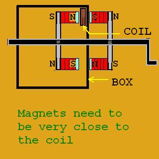

mulligan
---------Cheers Roe

Greenbelt
Very nice rendering of my contraption. I had my magnets aligned as such, although the coil was placed differently; I had made the coil the identical size of the rotors diameter, so the magnets were spinning along the circumference of the coil throughout their rotation. Could this alignment have caused the "cancellation" effect I was previously warned of? With the coil set off to one side like you rendered, should the magnets pass through the center of the coil or along the outside "legs" of the coil?
