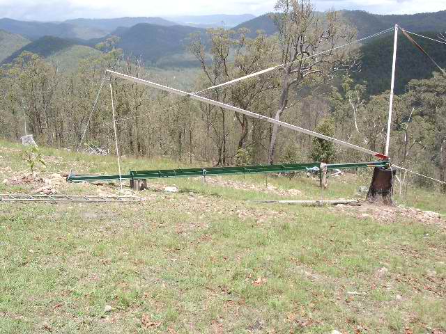

This one is tricky(for me).
The base block and attachment steelwork is fitted for my mast. the land is sloping quite a bit , forward and aft guy anchor points are not a problem.
Now ,the big question is , how do I calculate accurately the side "point-of-attachment" length from the centre ,say 30 feet out from centre  ?.  The high side is no problem as the ground is level at this point-just drive a peg in at 30 feet.
The other side of ground falls away --is there a easy way to accurately measure and peg the point -of -attachment for this side ?
any takers?
Thanks Bruce

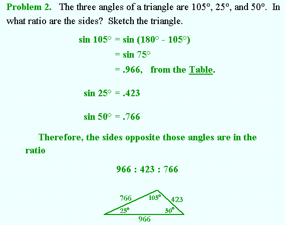

Yeehaw, trig isn't as hard as I remember it!, theres a massive amount of info on the net.
If my understanding of your problem is correct, then I've found a nice little way to work out the ground length, thats if the mast/wire angle is known, and the mast/ground angle is known, and the mast hight is known.
It's simple ratio's:
The mentioned table is here:
http://www.themathpage.com/aTrig/trigonometric-table.htm
So, for this example, if the 766 is the mast and the 423 is the ground, then the ground length is 423/766 = 55.2% of the mast height. Nice.
to quote the website:
'The sides of a triangle are to one another in the same ratio as the sines of their opposite angles' - the Sine Law apparently!
Ok, hope that helps, sorry for the multiple posts, and all the thinking out-aloud!

Thanks Simo--- just knew there was a bright a#rse out there--hahaha.  sort of all came back to me when that ratio thingo was mentioned --
Now, to clarify, the back and front guys -forget them,as they are the raising/lowering guys.dosen't matter what length they are.
Now, the side guys(2 of them) they have to be equal length so as when the mast goes up and down there is equal strain on these 2 guys ,keeping the mast perpendictular and safe in it's decent.
Thats where your stuff comes in -- we know the height,say 25feet, we know the distance out from the mast we would like ,say 25 feet. Now ,what we have to determine is a distance out from the mast base along the raising or sloping ground !. on raising ground it would be less than 25 feet and  more than 25 feet on falling away ground.
Thanks ,  Dumb bruce

Posted: 01:43am 12 Nov 2005
Thanks Simo.   I've just about got it figured out --give or take a couple of inches-
I've installed the front and rear blocks and will raise the mast on these with temp. side guys--from here I'll work out the close -as-can position .
look in my album and you'll see the progress.
Bruce
