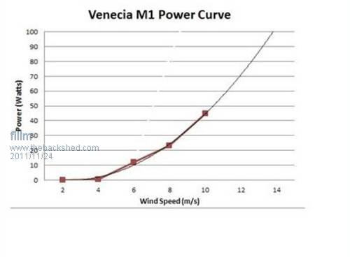

Hi, New site for open source VAWT, what I like about the site is that it gives a indication of the power you can except for that size VAWT and wind speeds.

Govertical , I think it's a great project for these Uni students to help a small village get some power , but I do question their advice and direction they are giving with the materials they have chosen . The output of this VAWT is extreemly dismal for cost of materials( Cut-in @ 4 m/s , 40W @ 10 m/s ) .
If the same materials were configured into a HAWT I would think the complexity of the basic engineering would be far less, and the Watt return on the material cost would be far greater than 40w@10m/s.
Don't get me wrong , its a nice story, but in reality for a small village in Nicaragua wanting to run a couple of lights and charge their mobile phones a $100 worth of solar would be more benificial .
