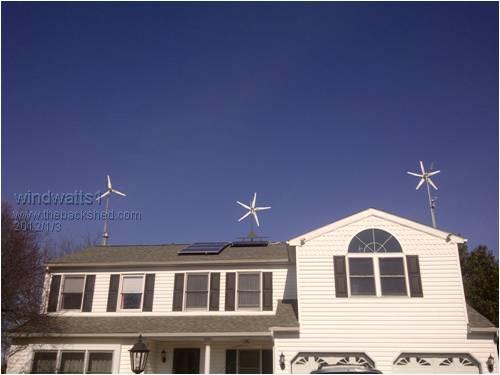

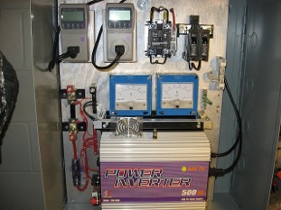

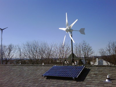

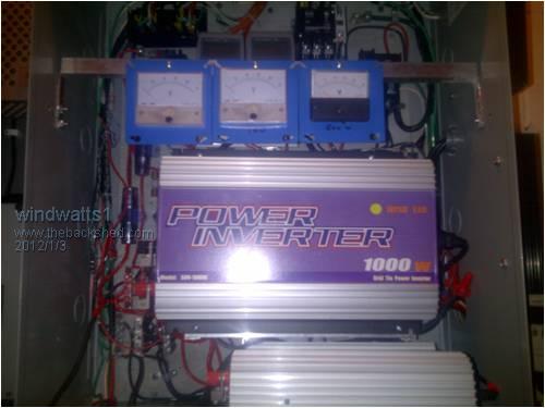

I am electrical contractor from Pottstown Pa. I install electrical, solar, and wind systems. Since i have gotten into micro wind in the 1kw class and under i have been trying to grid tie for two years. Not much on the market for 24v turbines, LOL
UL inverters is not worth the money to me for what i have in wind so i thought i would take a crack at the China ones. Well, since the Sun G wind rated ones came out i have had some great sucess with them. Using 3 Wind Max 24v turibnes HY 1000, HY 600 and the HY 400. I have made a nice little control system for them to operate to the grid. I have made a custom roof mount bracket for my 1kw which has been installed for two years now as well as custom side of the house pole mounts. Since i live in a residential area i had to find ways to accomadate what i wanted to do in a small space. It's been a long road to get where i am considering i could not just stick a 5kw up and be done. Some of the pics are older and some newer. Please enjoy and thanks for looking.
2kw of wind and 2kw of solar grid tied.
Posted: 12:28am 03 Jan 2012
Thats a very nice set up windwatts. The windmills look good on the roof. Good work.

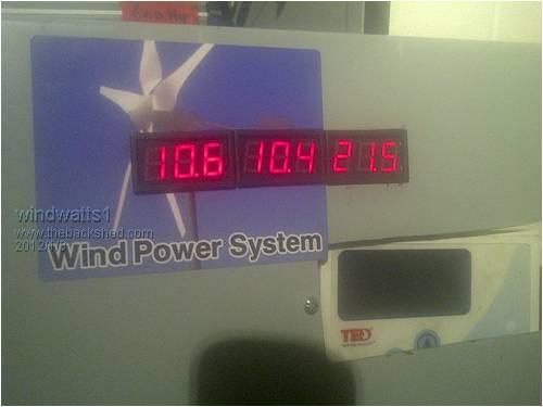

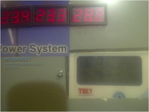

I am so glad to hear those words. Thanks. Yes they do work well but they are particular to what they like in regard to the type of turbines and how the are wired. No good directions come with them so it does make it harder. Some have had really bad luck with them as other have not. After all of my testing i have found they are more then just hooking them up and plugging them in. I have found that the turbines that work very well with them is the 24v rated ones. 1kw and under. A Wind max wind turbine (HY 400, 600, and 1kw) that i have and tested with these inverters and i have had great sucess. I do not have extremley high winds but we do get those occational 30+MPH gust's. Our winds are mostly 6-20MPH.
Here is a pic of my system with digital volt meters and a TED energy unit to measure he AC watts comming in. This was last week (12-29-11), 990w, made 3kw that day (24hrs). Not much but all in fun of course. I am looking to get about 2,100w again if he winds would agree.
