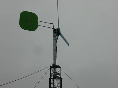

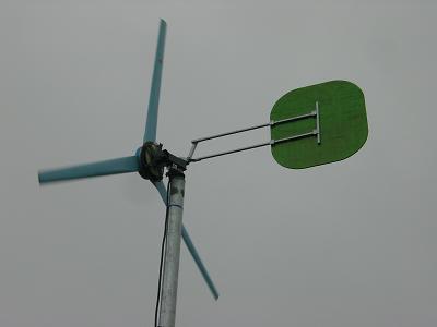

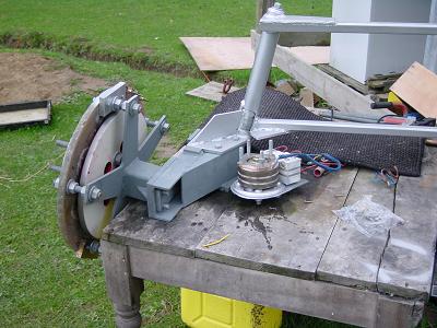

Its taken me ages but here it is and for those that have forgot it has 4 meter chainsaw blades, sliprings, adjustable mast offset, and adjustable tail length
9 coil 24 magnet alt and the tilt up tower can go as high as 20 meters I have it at 12 meters at the moment.
Its charging my bank as i write this

Nice work Shawn.
Yeah for turbines that size you cant do much better than the chainsaw made blades
When you get some figures let us know.

Hi guys just a small update on performance had some good wind the last two days the controller should be going on this weekend. but I hooked up a shunt and 200 amp meter
the mill liked to sit around 40 amps and spikes up to 70 at this point its folded up and droping back to around 40/50 amps into my 24v bank at the time at 26v so 1800 watt spike and happy at around 1kw.
Im sure I could push it harder but there is no point its the big prop in the low wind im aming for.
the alt makes a rumble when working hard prop is quiet my house is 40m away and inside with my head out the window I can hardly here it at full output.

Hi Shawn
Yeah good figures. Sounds like the furling is working well too.
If your happy with the figures, I would leave it as is. If you get a chance, have a look at the stator to see if there are any signs of over heating. If it looks fine, then you have a good reliable windmill.
Chances are you could get more power from it, but with more power comes more risk, and you could end up with toast.
