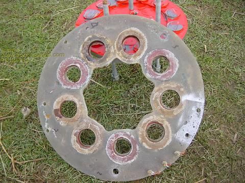

It seems my pile of dead bits still grows trouble is its the shortest daylight time of year and my PV is slow not to mention 1 meter of snow on top of them
Anyway here is a picture of my failed mill

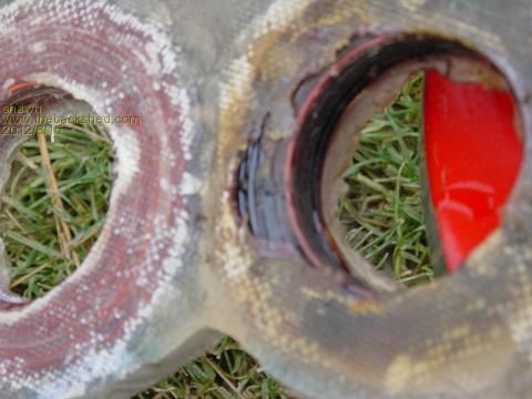

Here is the worst coil

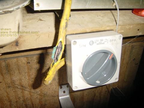

Here is the lead to the kill switch
Oztules blades just have to much grunt! Ive seen spikes of over 100 amps easy and they didn't cause this!

Sorry to see the burnt stator shawn.

By the looks of the stator it appears that one phase has lost loading somewhere this could have caused the other 2 phases to be loaded excessivly but with 140k up its clakker 3 cricket bats would do the same, I take it that when you have said detuning means 4m blades are a bit on the big side for the winds you get there and knocking them down a bit would be a good starting point for the next build, if so that would be a good move,
As I have been logging and watching how quickly my AXFX stator heats up when the load comes on, it's not surprising when you can see this and makes you realize how they can very easily burn out from being over driven . Once over about 500W things start heating up fairly quickly and if you are thinking about more copper I would be increasing the wire dia and keeping the coil count the same if your cutt-in is good and go for better current carrying, it looks like you have a heap of room to do it.

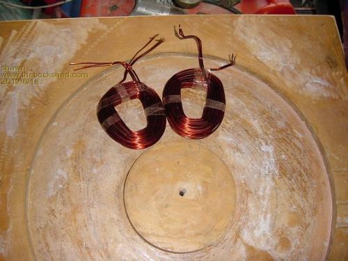

Had the afternoon off work, so I dragged my old coil winder out and threw 3 inhand of 1.6 wire in it and wound it up same turns and it is a very tight fit! no chance of putting in more than this! the last stattor only had 2 inhand so a big inprovement
thought I might try anouther coil shape not sure which is best but i will find out soon enough?
