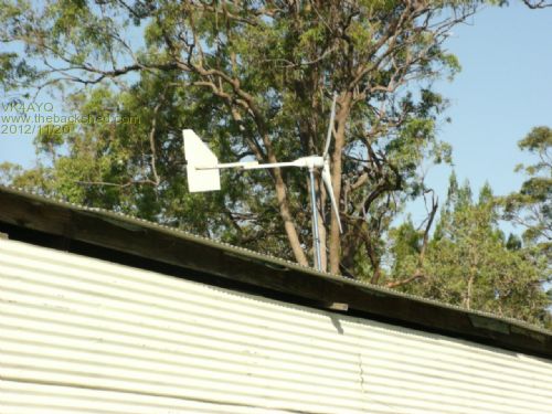

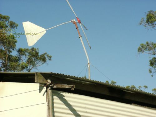

Here is some pics of the OEM with bent mast and the old mill still running.
The old mill is still up and running, it uses a slightly larger pipe for the top of the mast.

Good to see it survived the wind event relatively unscathed, by the looks you have the guy wires attached to the top tower flange. My advise to all who have bought one of these and have done the mods, especially with extending the blades is to weld on guy wire anchor points as close as possible to the blade dia arc. As you have said it is only 50mm and it needs all the support it can get .

The attach points are just outside the blade radius and about a foot up from the original joiner flange, which was cut off and the pipe was slipped inside the two inch mast pipe.
I think I will make a hinge joint there when I take it down as it would be easier to work on if I can lay it down, also it would make the top pipe stronger.
I think if it had standard blades it wouldn't have bent as the extended blades give double the swept area of the original. Like all things modified it finds another problem to deal with.

It is a real casual mill as it shows a lay back attitude, actually I think it was trying to capture the down drafts

Its a "Half Mast" mill, half way a Hawt and half a Vawt.
You were lucky it didnt bend right over, as it then would have been a Helicopter and lifted the roof off the shed.
But more seriously you were lucky it did not spin around on the pole and the blades smacked the pole, as normally happens with a bent pole
Pete.
