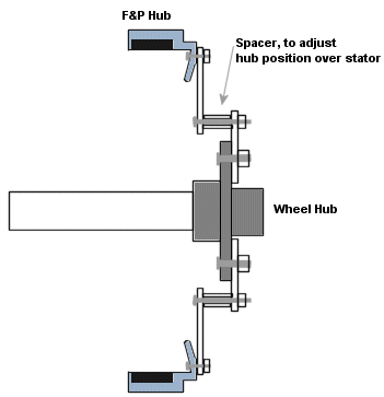

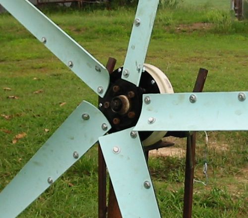

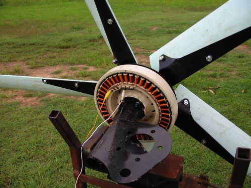

Your design is very similar to my first F&P windmill. These photos are not the best, but they may give you an idea how I did it.
I cut the center out of the magnet hub, except for a rim of about 1 inch. This was then bolted, using the existing drain holes drilled out to suit 1/4inch bolts, to a 2mm steel plate, which in turn bolted to another steel plate with holes to suit the studs on the wheel hub.
I could adjust the spacers to align the hub over the stator. It worked ok, but I remember I had problems with the hub not centered correctly.

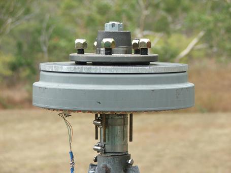

I have posted this picture before and it shows how to support the plastic F&P rotor to keep it stable on a stub axle.
The rotor will still distort if it is not in operation, or left lying on its side or if not strongly supported.
In the picture it is screwed to a thick alloy plate which in turn is bolted to the wheel hub. Even then if it is not spun for a period of time occasionly then re- centering is needed.
