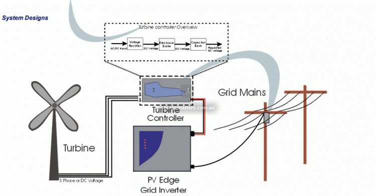

The typical solar grid tied inverter has a large input voltage range maybe in the range 110Vdc up. If I found a turbine that produces an output in this range or I installed a transformer, can I connect the turbine to the inverter without the need for batteries? I have seen recommendations in other forum posts to use a battery bank between the inverter and turbine (Lantronix for example). I was wondering if the typical inverter requires a rather steady DC voltage delivered from batteries or if it could handle the turbine dc voltage which is up and down and all over the place.
The reason I ask the questions is that it is such a waste to see a Solar panel inverter not being utilized at night. Perhaps a wind turbine could be attached. But then if I have to add 10 batteries I might aswell purchase a 2nd inverter, ie the Windy boy which doesnt require batteries.

Its a question that comes up every few times a year, and if the answer was simple, dont you think we all would have done it years before and told the rest of you how its done.
For example to wind a mill for 240v compared to a 24 volt mill, it would require 10 times more turns per coil, which is a lot of copper wire to fit in a small area.
Nice thought but no easy answer that i know of.

Regardless of the output voltage of the turbine.
My question is whether or not the batteries before the inverter are necessary. I would think no but then maybe someone knows something about these inverters that I dont.

http://www.latronics.com.au/products/turbine-controller
Posted: 03:18am 01 Jan 2013
Your question was to use the GTI to feed power from a mill to the grid, there is a range of problems here, from high enough voltage from the mill to reach cutin, then anti islanding and connect delay of a GTI, etc.

360 volt turbine with on grid controller

I am informed. Thank you. I noticed the Lantronics Turbine controller still uses a capacitor bank as opposed to batteries. I guess the capacitor bank is necessary to dampen sudden voltage spikes.
