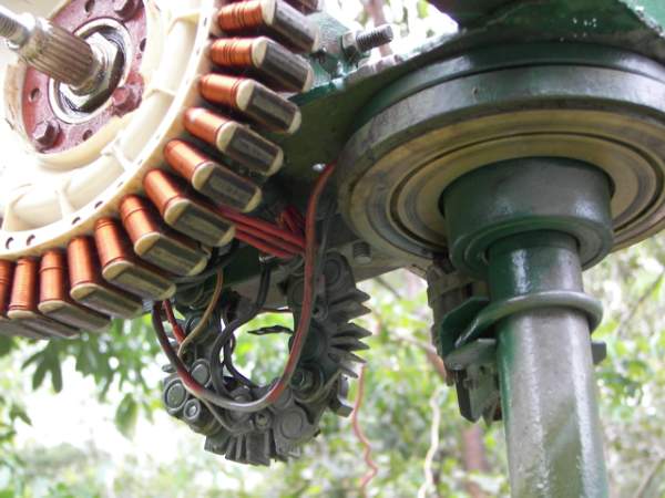

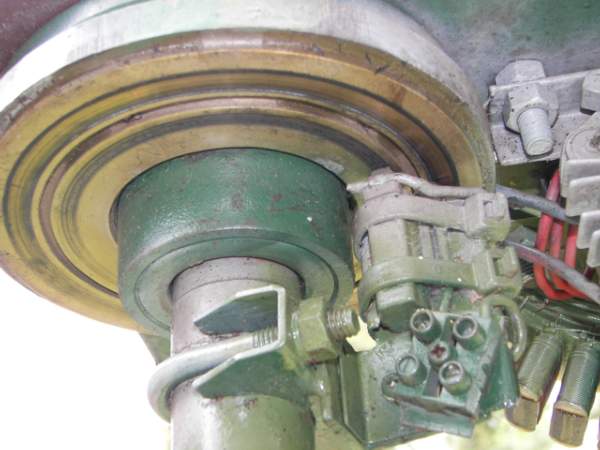

My first mill uses horizontal slip rings
Yaw pivot is trailer stub axel and hub which suits this slip ring setup.
Others pivot types suit band style rings.
