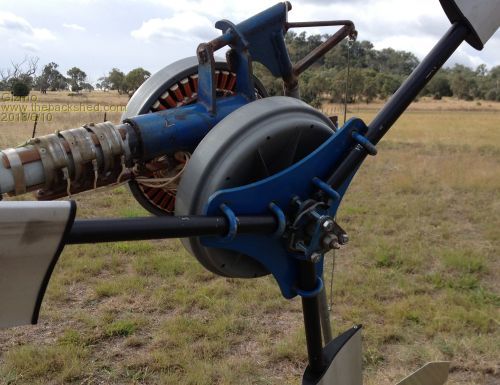

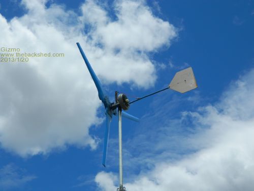

Just thought I would share some photos of my little windmill. Its the F&P based turbine, furls around 250 - 300 watts, nice and reliable. A couple of nights ago I had 100km plus winds through here during a storm, my house was swaying , so I thought I would take the mill down to inspect and lube.

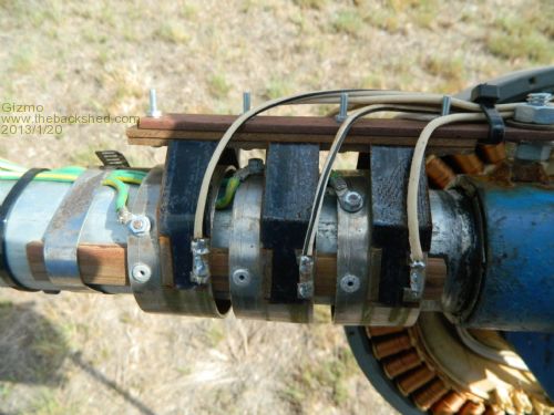

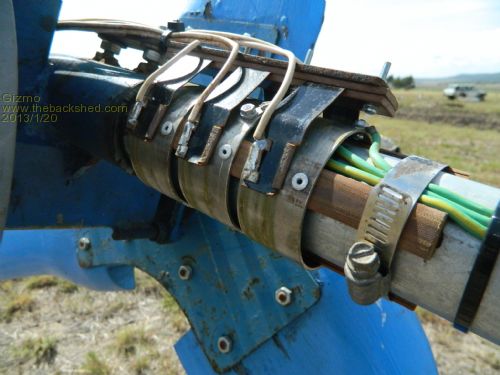

I made a set of brushes and slip rings for it a couple of months ago, using stainless steel exhaust pipe as the slip ring, and copper brushes made from springy strapping steel and flattened copper tube. This was the first time I've taken it down to see how its wearing.
Seams OK, especially considering its exposed to the elements. Conductivity is good.

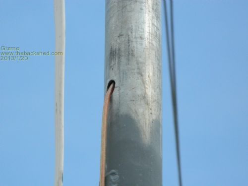

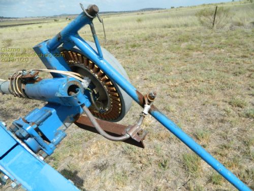

I also added a manual furl to the tail, and I can highly recommend it for any home made wind turbine. I used a length of copper pipe to guide the pull cable, and its dead easy to pull the tail into a fully furled position, as shown here. When released, the tail falls back into its normal position, and furls automatically with increased winds.
The cable comes out a hole about half way up the mast.

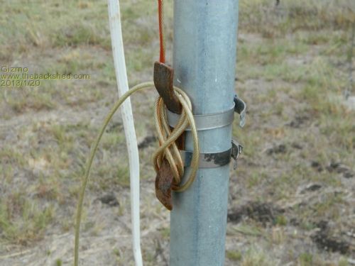

And its tied off here, about chest height.
Everything was looking OK, check the electrical terminals, dropped a little oil on the bearings, etc, and raised it back up.

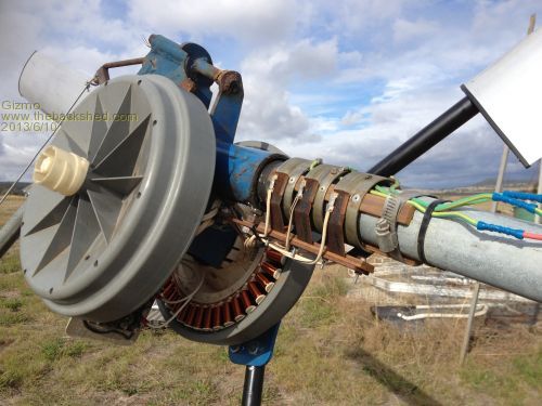

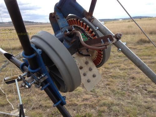

Just another update. The single stator windmill worked well, and endured a few strong winds with no problems.
I've since swapped it for the dual stator windmill I build several years ago. Made a few modifications based on suggestions from Phill. It's a staggered stator configuration ( see http://www.thebackshed.com/Windmill/articles/StaggeredStator s.asp ) with one stator wired as a 1X14C delta ( see http://www.thebackshed.com/Windmill/FPRewire.asp ), and the other as 2X7C star. Both stators are 80 series, and the staggered configuration gives different cut in RPM's for each stator. This means I rectify at the top of the tower, and feed DC through the bushes.

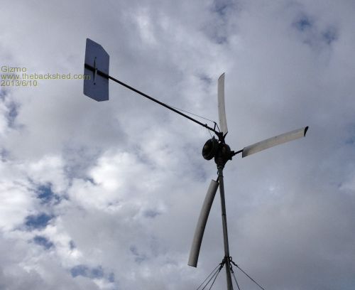

The blades are Phills aluminium GOE222 blades, sitting at around 2.8 meters diameter. Tail was lightened and lengthened, hinge angle reduced, and I hope to see it furl around 600 watts.
The brushes are working well, been up there for several months now and looks like copper on stainless steel is ok, little wear and low resistance.
I also added the manual pull cable to furl the tail when needed.
The blades looked curved in that last photo, its just the slow shutter speed on a phone camera.
Watts are good so far. Only been up for a couple of days, but I've seen 150 to 500 watts most of the day, with no strange noises or wobble. Even in the lightest of winds that wouldn't blow out a candle, its making 20 to 50 watts. Still waiting for some strong winds to see how it furls.
