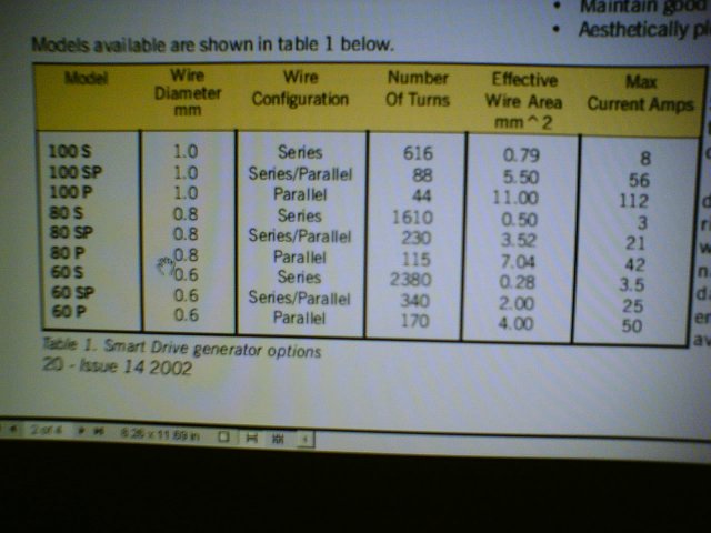

got this from a friend, dont know if he wants to be named.
