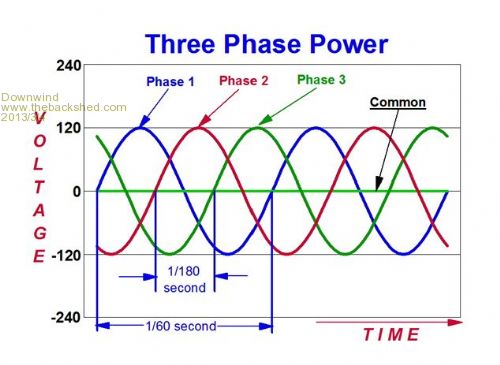

Posted: 02:59pm 03 Mar 2013
  Quote  Pete, if you have three 100 watt light bulbs connected to three phases, are you suggesting there can only be 200 watts because one bulb is always off ?
Tony, its not a claim only a point of view that 3 phases and windmills dont workout the same as 3 phase mains.
For starters we full wave rectify the 3 phases, the only real part of each wave cycle we are interested in is the peak to peak voltage, so any voltage less than the peak voltage contributes nothing to our DC supply.
If we used a motor on the 3 phase i would see it different than just rectifing it, if we used light globes on each phase then we would need a separte neutral point, which we dont have or use with a wind generator.
With rectified 3 phase would it not be correct that only 2 of the 3 phases are supplying full power through the diodes at any one time.
Pete.
Edit.......
Looking at this wave image.
My theory might be wrong as only 1 phase would be at peak voltage (either side of common) at any one time, remembering we are rectifing the power and using peak voltage.Edited by Downwind 2013-03-05
Warpspeed
Joined: 09/08/2007
Posts: 4406
Posted: 04:56pm 03 Mar 2013
Yes you are quite right, rectifiers have very different form factors to resistive loads.
As I stated in my first post, my calculations were based on a resistive load and unity power factor, which is how cable losses and wiring sizes and temperature rises are all generally calculated.
Now a six pulse three phase rectifier, as you have shown it, behaves very differently.
The dc output voltage is not the RMS value, but the peak value, less about five percent (minus two diode drops).
The current in each phase becomes a square wave with a peak value equal to the full dc output current, but it is only there for one 1/6 of a cycle in one direction, and 1/6 of a cycle in the other direction.
For 2/3 of each cycle the current in each phase sits right at zero.
This alters things considerably in many profound ways.
The rms current in each phase will be 82% of the dc output current, not 33% as some people might expect.
So if we take an rms (per) phase current of 63 amps, the dc output current from the rectifier is going to be 76.8 amps.
What all this means is that we have three wires each carrying 63 amps rms to generate only 76.8 amps dc which is not a very efficient way to do it.
A much better way would be to put the rectifier at the mill and feed the power down two cables each 1.5 times larger. That would require exactly the same amount of copper.
In one case we have 63 + 63 + 63 = 189 amps circulating around three wires
In the other case we have 76.8 amps flowing around only two wires which are 1.5 times the cross sectional area.
Let's use some crazy numbers here. Say the dc wires would need to be 0.1 ohm each, and the three phase wires each 0.15 ohms (same length, same amount of copper both examples).
I^R losses for each of three phases 63 x 63 x 0.15ohm = 595.35 watts.
Total power loss all three wires 1786.05 watts.
I^R losses for each of two dc wires 76.8 x 76.8 x 0.1 = 589.8 watts
Total power loss for two wires 1179.6 watts.
You can see, using the same amount of copper, placing the rectifier at the mill reduces copper losses by ONE THIRD.
Three phases are a very efficient way to send power over long distances, but only where the load is resistive.
If the load is a rectifier, or has a very low power factor, dc can be a much more efficient way to transmit power.
Cheers,  Tony.

Posted: 11:43pm 03 Mar 2013
Tony,
Im not trying to create an argument here, just asking about a theory with 3 phase and a windmill situation, due to my thoughts on using 3 phase rectified power, and not modeled on a standard 3 phase mains house supply which i feel most calculations are done by, which im questioning if that method is flawed when it comes to rectified 3 phase for the use of battery charging.
With your last example of house A (A) house B (B) and house C (C), then yes you are correct, but if we adjust the example to better suit a 3 phase rectified situation, then "A" would switch his power off before "B or C" switched his power on, and again "B" would switch off before "A or C" switched on, so in reality only one source is on at any one time.
To muddy the example a little we need a return path for all this to work (we have no neutral or common as you would in the house power example) so which ever phase is not active will be the return path, meaning if "A" was active then "B & C" would be the return.
Then it gets a little deeper if this is the case, because if we have 2 cables as a return then the cable resistance on the return is half that of the active supply.
Like i said its just a theory, and im asking for others points of view, as doing the calcs on the theory shows big differences in resistance losses to cable size, and experience with wind turbines suggest the standard 3 phase calcs are wrong, and im just trying to work out why to offer better advice.
Pete.
