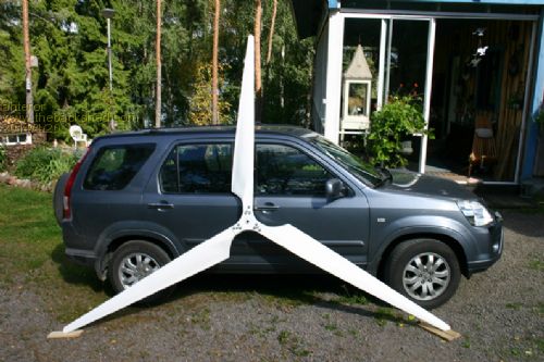

My blade area is 12m2 = 129 ft/2, blades are 1,9m each = 6,23ft.
Diameter is with the hub 4m = 13ft.
They sel windgenerators with blade area , that is just a fraction about
this and they give the same power reading.
Picture about Huyaturbine 2-3kw(I have got over 4Kw..) blades.
With just moderate wind you REALLY get energy 1-2Kw.
For dimension, to understand, Honda CRV;
Antero
