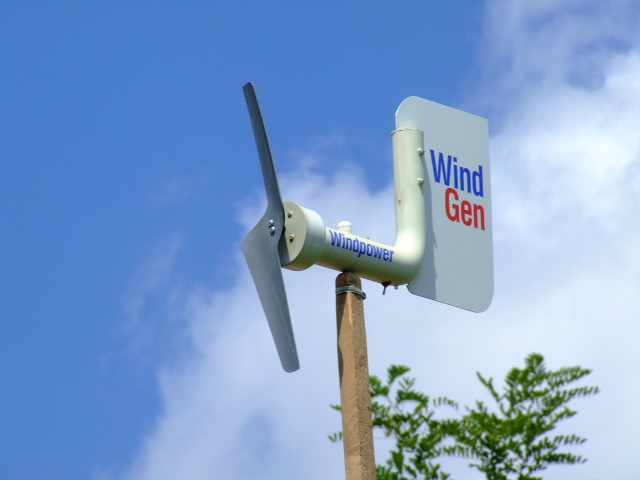

I received an email from Claude about his mini-mill, he included a couple of photos and I thought it looked so good I decided to post it here. It was based on my Mini-Mill design here.
Claude's email...
"Here's a windmill made by following your plans for the stepper motor windmill but with a little upgraded electronics.
The miniwindmill has small stepper motor that charges a 8.4V/400mA battery. It also has a light sensor and a single LED as a light, pointed down from the tale. As the night falls, the little LED lights up for the entire night. This little windmill is working for more than a year already and it faced some severe storms with no damages. The body was a elbow flush used for toilet tank.
Claude"
Well done Claude, it looks like a bought one! Its also inspired me to dig up my original Mini-Mill ( the one photographed in the article ), its been leaning against a rock and over grown with grass for the last 2 years. I found it this afternoon and although the timber tail is gone, the rest is in good condition and still turns. A new tail and some oil should have it working again.
