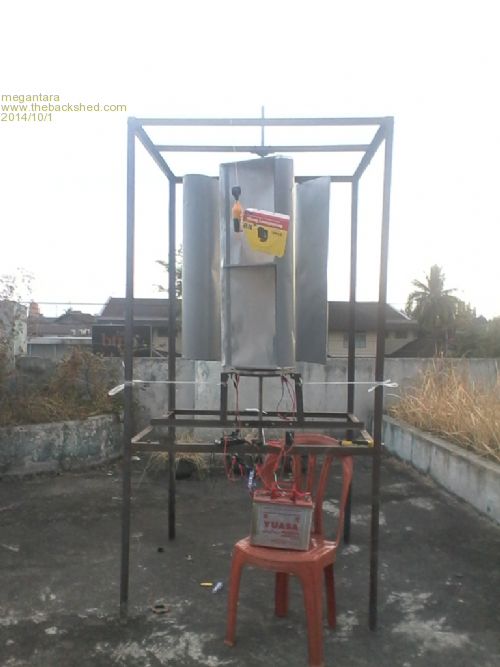

I've built a lenz2 type turbine (1m height, 0.9m diameter), with 9 coils (170 turns, 1mm wire diameter each), and 1" x 2" x 0.5" N42 magnets.
Average wind speed for a week is around 3-6m/s with 10-12m/s gusts

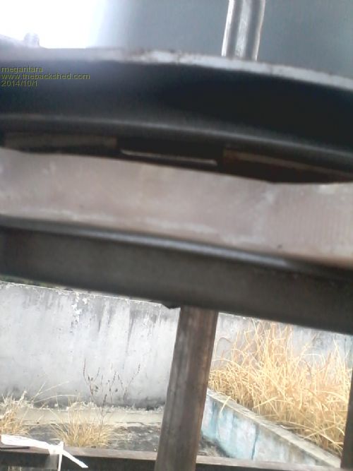

3. i stupidly stuck my magnet to baking pan (not smart, didn't finish reading materials), then stuck the pan with magnets to round iron plate (3mm thick). Is there a good way to remove the magnets without damaging it. Note: can't turn/pull the pan from iron plate
4. is 3.4-3.6 ohms/phase a good number? what resistance should i look if i decide to make new stator? (i want my system to work @ average 4-6 m/s wind => 50-80rpm)
5. is my stator coil damaged as it only produce 3-5 volts open circuit @ 40-60rpm

The proportion is not straight, should be 1.2m x .9m (4 ft x 3ft), 1x1 aluminum sheet is the largest i can get, thus came that 1x.9 the ribs are to ed's design... only the height is modified.
For my defense, i didn't have any clue that steel thickness will affect magnet strength... now after the pan stuck to 3mm iron plate, the magnetic force is too strong that i can't remove or slide. Gonna try wood trick next weekend.
I think i did my alternator good enough (should be better without the pan). I draw circle, then put my coils in 40 degrees angle, and the magnet is 30 degrees.
Update:
Today after work, i try putting another pan under the stator, and the output rose by 2v. Apparently the flux better with pan under stator. I'm gonna get another iron disc before going to work tomorrow to see if it will work better, then go for dual rotor.

Your 50mm x 25mm x 12mm N38 Neo Magnets need to be mounted on a 8 ~ 10mm steel plate(dont know what a pan is). If a pin sticks to the plate behind the magnet you are loosing Flux concentration & Density.
Mount the plates on there bearing with the magnet faces 15 ~ 18mm apart and make a test coil , only 10 or 15 turns out of any size copper wire .
Attach the 2 outputs of the Test coil to a Bridge Rec and put a good size DC capacitor across the + & - of the rec and then attach your MM leads.
Spin the dual rotor at you desired RPM and take the DC reading of the MM , then the next is only an example .
Say your test coil is 10 turns and the DC volts on the MM read 2vdc @ 50rpm .
Then - 2 / 10 = .2 ....then allow star connection and 3 coils in series - .2 x 1.75 x 3 = .35 x 3 = 1.05Vdc per turn @50rpm .
Charge for a 12v system = 15v + 1.3V Bridge Rectifier loss + .7 v wiring Loss = 17vdc the alt need to be at for the desired RPM ... 50
17vdc / 1.05vdc = 16.19 turns per coil or go (17)... so I would use the biggest copper wire possible and always room limits this or you can use 2 or 3 smaller wires in hand to get the wire DIA up for max current with no heat .. WARNING HEAT KILLS THESE ALTS VERY QUICKLY . but if you continue to build the VAWT you will not have to worry about heat.
Use Epoxy Resin not regular Polyester Resin to make your stator as it shrinks and warps to easily and have fun learning .. Post some pics

I used fiberglass resin for stator, and the result indeed not good, got some crack when its done. It costs around US$ 2 a liter, compared to $25 epoxy resin (resin+hardener). But i'm thinking to use epoxy once i get the best configuration for my need.
took some vids afternoon
charging 4v flashlight battery
http://youtu.be/RXaU_EWZJ6E
with anemometer, 1-3m/s wind
http://youtu.be/AzQVzKvRLBQ
stator, rotor, and pan
http://youtu.be/9uMcHMrPvOY
took just now
http://youtu.be/AMfbBhyE4eA
sorry... was using phone camera to take the those
Edit:
The frame was shaking quite awful in 4+ m/s wind, and the orange thingy hanging on the frame is anemometer tied to a string with tails behind. Crude, but that's the only thing i have lying around before taking pic/vid.
thank you for your feedbacks, i'm gonna see what can be done with this while saving to buy new set of magnet. Hopefully i can get them by next month. For now i'll research more, and review the things i did wrong in my 1st attempt. This project was money well spent... much better than spending it on bar or gadgets i wont use fully (like iphone or ipad, lol).
Edited by megantara 2014-10-02

i 've built close to a dozen alternators and never had a problem with polyester resin as long as you let it cure slowly .
it's not suitable for bedding mag rotors 'cause it shrinks .
your mill looks good .
is it balanced? as in, turn it side ways and see if it favors one wing over another.
