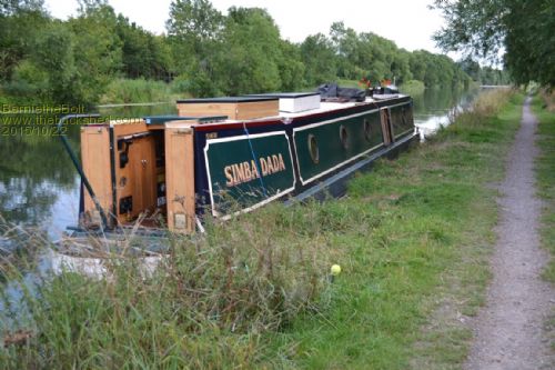

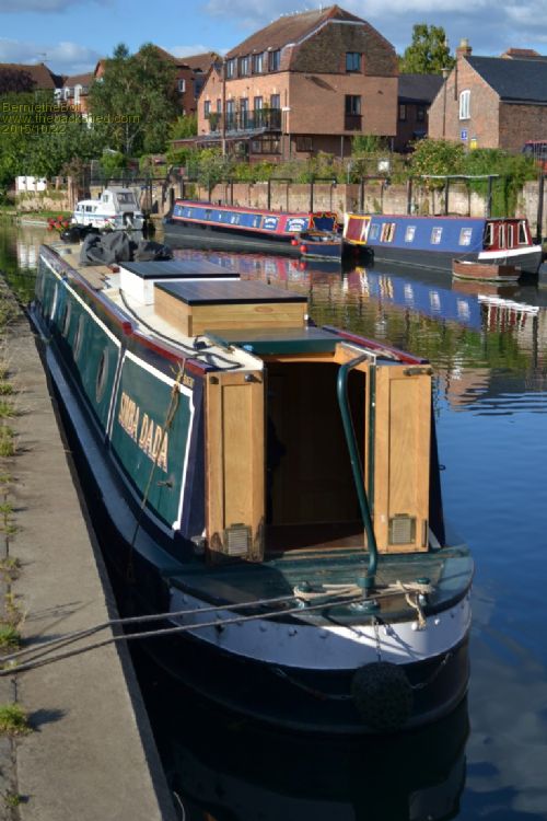

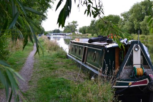

Here art pictures as promised of "Simba Dada"

She's a nice looking boat Bernie

  Gizmo said   She's a nice looking boat Bernie
Agree with Gizmo, nice looking boat indeed.
