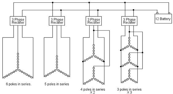

I'm planning to put up a dual stator windmill this weekend, and was contemplating how to configure the stators.
I was going to connect both stators the same way, both as 7 poles in series, 3 phase, 80 series wire. This would give a low cut in speed. Then I though it would be better to configure the windings into different coil counts, ie one series of 6 poles, another of 5 poles, etc.
After looking at a few options, I've come up with the following. I have two stators, each with 14 poles per phase. As the windmill speeds up I want the strings of coils to cut in at different speeds, remembering at the lowest speed there is less power so I want to draw less power from the mill, and at higher speed there is more power so I can increase the load.
The lowest speed cut in will be a string of 6 poles, this should supply a couple of amps under 100 RPM. Then as the windmill speeds up, if the turbine is making the power to overcome the 6 string load, a string of 5 poles will start to make power as it reaches battery voltage. After that I have two strings of 4 poles in parallel, starting to make some good watts now and the wind has picked up. Lastly there are three strings of 3 poles, for max power in very strong winds.
Each of the 4 different configurations will need its own 3 phase rectifier. So I end up with 4 power sources each reaching cut in speed at different RPM's.
This is a non linear load, as the wind increases the load increases exponentially, sort of thing.
What do you think? I know the Air-X windmills use two windings of different coil counts, one for low speed and one for high speed, so I think it should work.

No switching, just a simple case of different cut in speeds.
The outputs of the four brigde rectifiers are all connected in parallel. In light winds only the 6 and possibly the 5 pole groups are generating enough voltage to provide a charging current, as the wind picks up the other groups come online as their voltages rise.
What it means is that instead of a single RPM = Charging Voltage, I have 4 different RPM's to reach charging voltage.

Yes thats right, but the 6 poles can only make 1/3 the amps of the 3 X 3 poles. Each pole of the 6 pole will be working harder as the windmill speeds up, but its own internal resistance wont let it exceed the wire capability, ie, it wont burn out. A single coil in a 80 series is only good for a few amps, its when we parallel them up we get the high currents.
The voltage wont go much above battery voltage because the relatively high resistance of the 6 poles in series cant compete agains the low internal resistance of a battery.
The F&P's are air cooled and I've never heard of one suffering damage from overload, tough little buggers. Good thing about a windmill is the faster the wind the harder the coils works, but because the wind is faster its getting better cooling around the coils.

Seems like a good idea Glenn.
It steps the loading which is like MPPT.

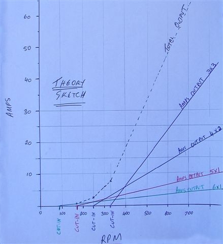

With Glenn's I could run 6 in series then switch in parallel an extra 4 in series, then another 4 for a short burst.
Here's how I see Glenn's assorted coil arrangement's performance:
I see it's key features being that it's output power is a closer match to the winds power (velocity^3) than a single linear generator. Also that it needs no external control.
Unfortunately this once again brings me back to the point of prop selection being a compromise.
