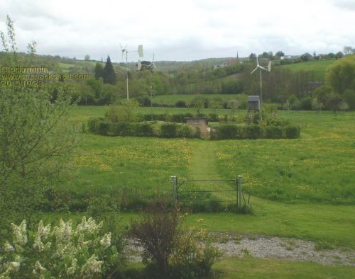

I have 3 off Hugh’s 3.7m diameter design flying, with No 2 & 3 having his blade design in fibreglass from my own created moulds.
My No 1 has been flying producing electricity for nearly 10 years now, and has survived Real Hurricane winds here in France, so they are definitely robust.
