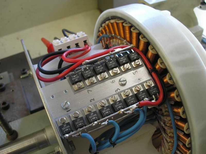

today I finally got my 7 phase conversion hooked up to my lathe to see what it can put out.
Quite impressive, I got 31V, 13.5A @ 550RPM which equates to a bit over 400 watts - more than I would have expected.
My load resistor values were limited so I could not do a decent output graph and the old V-belt I used to drive the shaft pulley started to squeal and complain at higher RPM's.
550RPM is possibly fast enough anyway for a home made windmill, must not tempt fate here .
I used a bank of 14 Schottky diodes from Oatley for the rectifier. They are $1.- each and are rated 10A/60V. The short alu channel they were mounted on only got warm to the touch when I ran it for a while, delivering about 300W into the fan cooled resistor load.
Now the fun begins with the propeller side of the windmill.
Klaus

Hi Klaus,
You say the diodes were getting warm. At 300W you have less than 2A per phase and you are using 10A devices. Something must be wrong somewhere. I use schotkey diodes and I only derate a factor of 2 with a SMD unheatsinked. You have a derating of over 5. check the forward voltage drop [FVD] with a DMM. Unloaded my devices have a FVD of 0.16V. The same device has a FVD of 0.3V at 2A and a MAX device rating of 3A.
I suspect that may not achieve the 550 rpm either as a mill. This will reduce the output volts and power proportionally. I assume the rewire is a star config, with just the 2 diodes at each end of the other winding leg.
Good luck with your testing, on the bench and on the tower.
cheers, Gordon.

Hi Klaus
Its good to see other's try the 7 phase conversion. I bet you were surprised at how little cogging there is compared to a standard 3 phase F&P. I think the 7 phase conversion is perfect for smaller windmills because it starts easily and is more efficient than a 3 phase decogged stator.
Just adding to Gordons posting, try spinning the F&P with no load and see if the diodes still get warm, just to make sure the re-wire is OK.

Thanks Gordon and Glenn for your comments, much appreciated.
I did run up the mill with no load at first, up to 39V at 300RPM where I stopped due the 60V limit of the schottky diodes.
Yes, its a star connection, as per the instructions on the 7 phase site. Two coils are connected in series and there are 3 groups of seven of those combinations in parallel.
I did try to measure the diode forward drop while the load was connected but get misleading readings, dunno why, maybe because one side of the diodes is at AC potentional. Tried with digital and analogue meters, there seemed to be a ridiculous high voltage across, not making any sense.
The diodes are connected in 7 pairs and a phase output goes to each pair link. All the diode + and - outputs are connected to common rails from where the output is tapped off.
I will try to borrow an oscilloscope and look just what I'm getting across the diodes. When I mention getting warm above it is actually 50 degrees on the diode body, measured with a non contact thermometer. The heatsink sits at around 30 degrees. That was after running for perhaps 20 minutes.

Posted: 11:17pm 01 Dec 2007
  Quote  The heatsink sits at around 30 degrees. That was after running for perhaps 20 minutes.
I think thats perfectly OK, but I could be wrong. When I was a tech we used to go by the rule that if you could hold your finger on a component for a couple of seconds then it was ok, but if you hear the sweat on your finger sizzle, its to hot.
Very neat looking install.

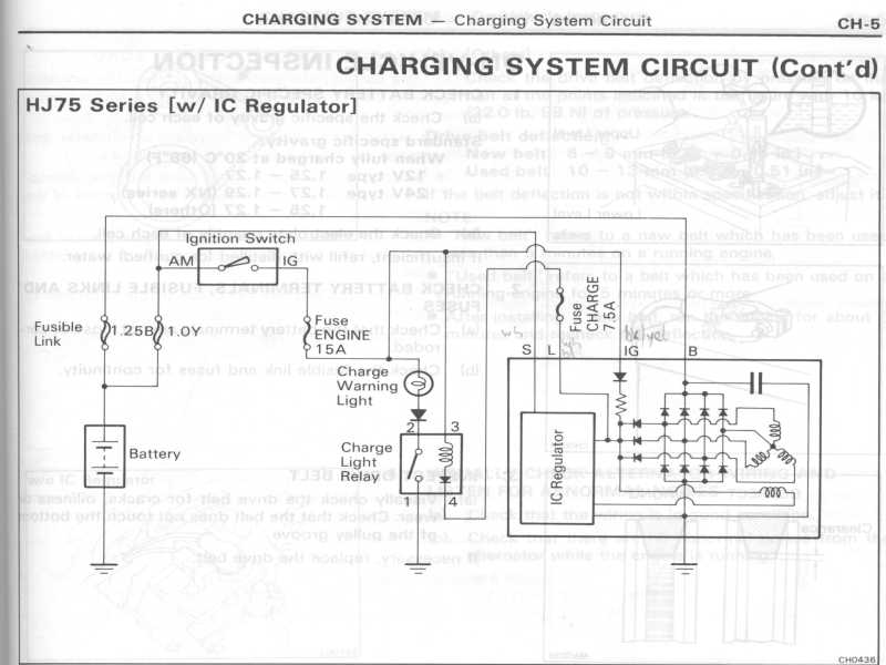

Another question re the diodes, you may have noticed that there are two vacant spots on the heatsink. I recall that in my landcruiser manual their alternator not only has a rectified output from of the three phases but also the star point.
IOW, there are 4 sets of diodes for the 3 phase output.
Is it worthwhile to do the same with the 7 phase arrangement and use the star point as a rectified output as well? I'm sure the Toyota engineers used that idea for a reason, even if it escapes me just exactly why.
Can anybody shed some more light on that?
Klaus

Hi tinker,
you will probably find that the land cruiser used only half wave rectification.
cheers, Gordon.

Tinker
Joined: 07/11/2007
Posts: 1904
Posted: 01:22pm 03 Dec 2007
  GWatPE said   Hi tinker,
cheers, Gordon.
No, it cetrainly does NOT use half wave rectification. AFAIK no car alternator uses half wave rectification, never heard of that idea.
I said there were 4 SETS (8 alltogether) diodes connected to the + - outut points. Exactly the same way as you guys do with the half bridge rectifier per phase. Only the star point is rectified as well and connected to the output which made me wonder why.
I'll try that idea anyway as soon as I get some more diodes ordered.

Posted: 06:38pm 03 Dec 2007
Tinker, I can only imagine the connection to the star point was to produce some lower or possibly negative voltage for some electronic circuit, maybe the regulator?

Hi all,
I have not taken an alternator apart, but from the ample descriptions the reason seems to be.
A picture will help.
Firstly draw a cube in line format. Only the lines joining the corners. Now make the top square the positive and the bottom square the negative. Now place 2 diodes, end to end between each of the top and bottom corners on the top and bottom squares.
Now assign the join of two diodes on one corner pair of diodes as the star point. Now draw 3, phase coils between this point and the join between each of the other diodes.
This looks like a delta arrangement with one end of each phase sharing a common pair of diodes. This is an engineering solution to reduce the total number of diodes needed in a delta output arrangement. This would make a star delta conversion possible using a single, double pole single throw relay to connect the diodes at the star point to the + & - rails when the alternator was to be run in delta mode.
I would think that the diodes at the star point would need to be a higher current rating though.
This is anyway, How I see it.
