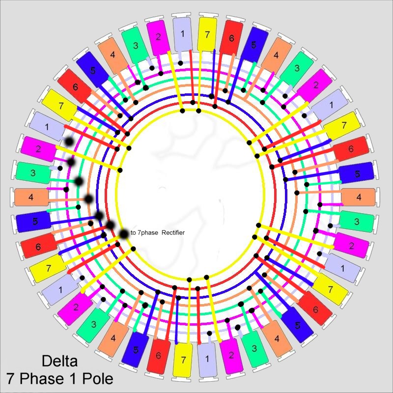

Here's that pic of 7 phase Delta you asked for some time ago.
As you see for 7 Phase 1Pole Delta:
out 1 in 3,
out 3 in 5,
out 5 in 7,
out 7 in 2,
out 2 in 4,
out 4 in 6,
out 6 in 1.
For 7 Phase 2 Pole Delta:
out 1a in 1b out 1b in 3a,
out 3a in 3b out 3b in 5a,
out 5a in 5b out 5b in 7a,
out 7a in 7b out 7b in 2a,
out 2a in 2b out 2b in 4a,
out 4a in 4b out 4b in 6a,
out 6a in 6b out 6b in 1a.
Now that's even harder to draw up, you'll have to wait a bit if you want that one too???
