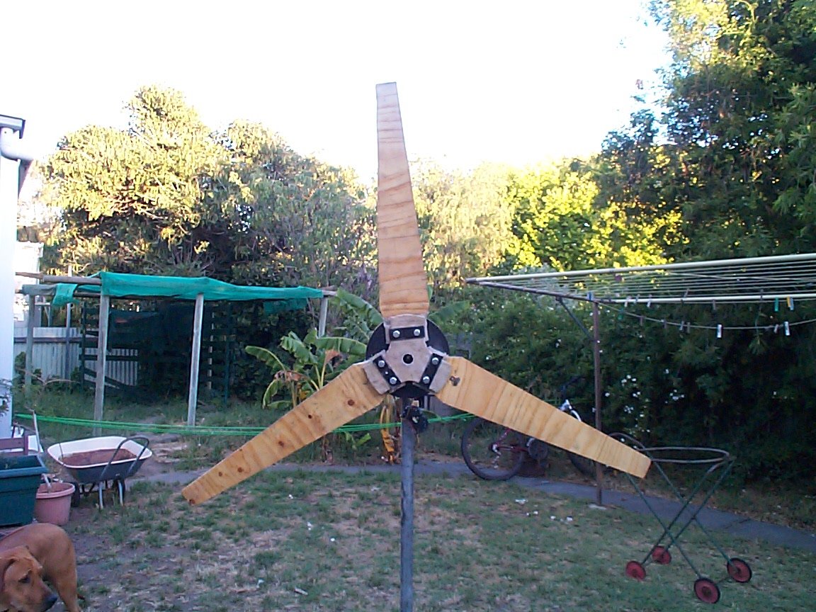

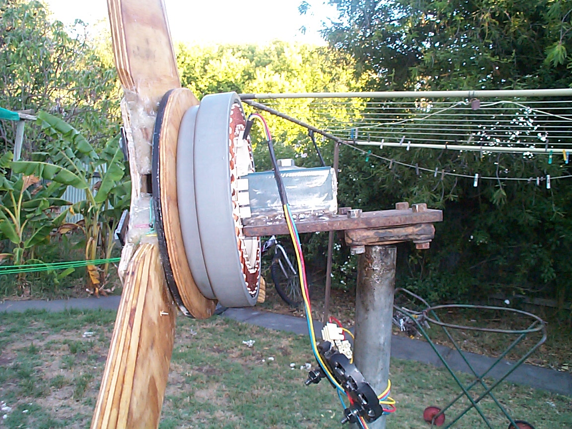

Hi fellow windmillers, first i would like to thank Glenn, Greg and Kiwi John for thier recent input, basically i have been looking at the best way to set up my F & P to gain most power. I have a property at Murray Bridge with Wind Power that can only be described as unrelenting. The wind has destroyed 2 sets of blades at 1200mm and i have now reduced my new set of blades to 900mm, i will fit up the new unit next weekend. I am deciding weather to rewire this unit to delta or leave it the way it is and put it up. Bench testing of this F & P 100s unit seems to be giving a heck of a lot of power ie i turn the unit slowly by hand and rectify it with an auto alternator rectifier and it puts out 30 + volts DC by the multi meter, i expect that given the wind power here that it would put out 500 + volts AC, i have seen my windmills spin so fast that they sound like jumbo jets !(a bit scary at times ) i need to rectify to usable DC battery bank charging and that seems to be the main problem. Any way here is a couple of unfinished photos. I have cut the shaft and placed a steel disc behind the rotor, the timber plate is a packer to overcome the stub that the plastic nut would normally be. The blades are from 18 mm ply all resined and the chords are fibreglassed, there is then a fibreglassed ply plare and 3 steel pieces of flat drilled out with 2 1/2" bolts fitted completely thru to the steel plate rhat has been drilled and taped, need to fit and balance the tail yet.

Looks good. The stronger the better I always say.
