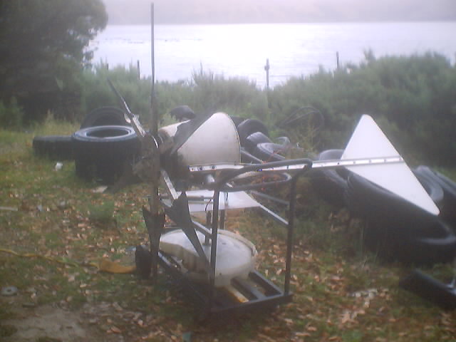

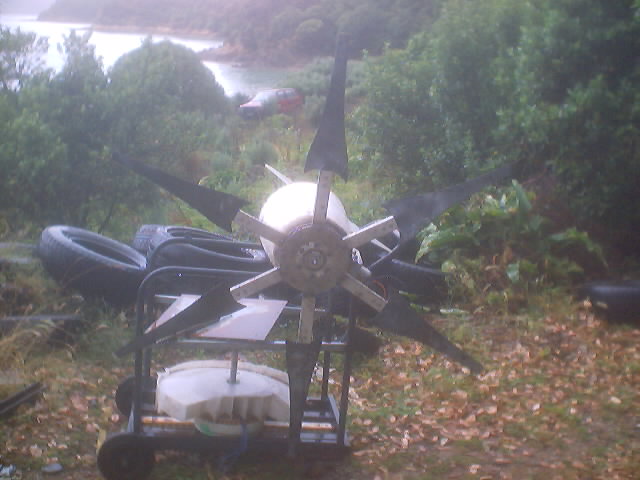

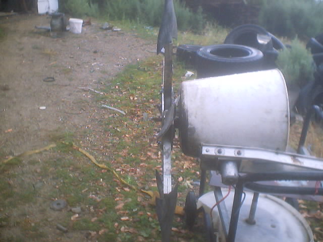

The blades on my windmill for the second time have come loose on the shaft and touched the tower. Being relectant to buy new blades (ex eco innovation) I have shorterned the blades. I would like to fit more efficient blades but as this mill has no furling I see my best obtion is to build a complet new mill. In the mean time I would like to get this unit up again .
What I would like is a educated guess as to what I could expect in the way of its ideal RPPM so I can choose a stator winding.
I have included pics the active area of the blades is now 410mm the dia overal 1.4 M . the blades have a standoff that is the differance.
I have this time put a flange on the shaft so the comming loose of the friction drive that was supplied is eliminated.
