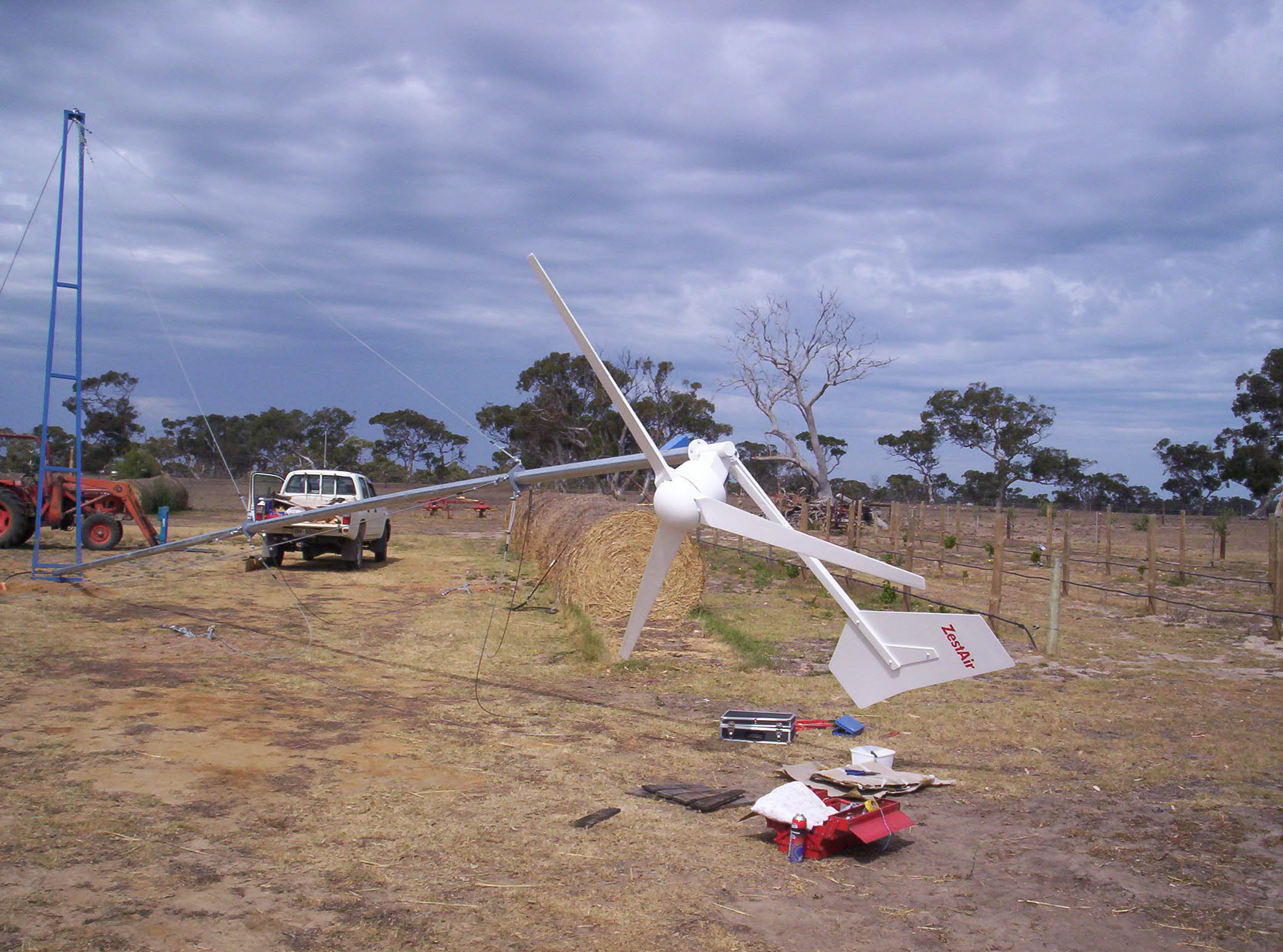

Posted: 01:31pm 15 Jan 2006
installed machine near lake alexandrina had to change the blades from 1.5m to 1.8m (3.6m dia) due to stator mismatch with load ok now can achive rated power of 900W @ 10 m/s

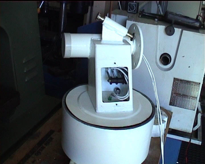

Posted: 10:18am 17 Jan 2006
side view of alternator and offset bracket and yaw tube,slip rings and brushes inside offset bracket
peter
Joined: 15/01/2006
Posts: 25
Posted: 11:06am 18 Jan 2006
 1.8 metre blade

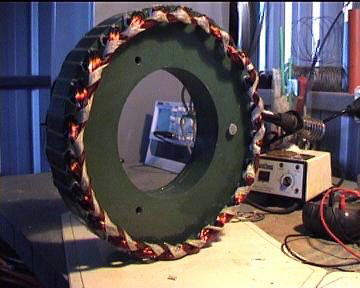

Posted: 09:12am 16 Feb 2006
300mm stator 48 slot
Posted: 09:36am 16 Feb 2006
Hi Peter.
Thats a nice looking stator. How did you come by the laminations? Did you make them or are they from a motor?
I have been tempted to laser cut a set of laminations, but they would only be mild steel and not the correct magnetic spec steel. I planned to paint them before stacking together to reduce eddy currents. But I heard mild steel would give poor performance, so gave up on the idea. I would like to revisit the idea one day.
peter
Joined: 15/01/2006
Posts: 25
Posted: 08:48am 17 Feb 2006
Hi Glenn
the laminations are made by me in a 2 1/4 ton press with a indexing table which punches out the slots.
I have made a set with proper electrical steel (silicon) the were very hard on the tooling and very expensive unless buying in tonnes, so I made a set from soft steel ahh yes i can hear everyone yelling hysteresis,,!!! hysteresis!!! losses!!! B-H curves ectect blah blah blah well the results are pretty good , the stator does get hot when the turbine is being pushed but it does'nt seem to worry it, under 'normal' operating conditions it quiet happily puts out 500-700 watts @ approx 5.5- 7.0 m/s without any apparent problems.
I suspect that at higher voltages and frequecies soft steel would not be so good.Smile

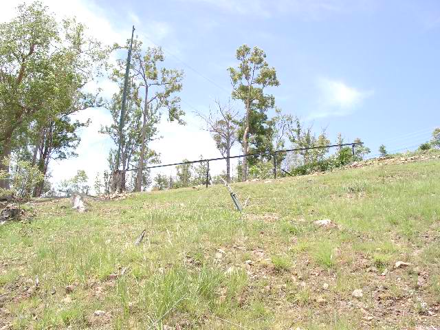

I had a look at the pic of the tower it does look like it's square but
it actually 89mm NB round...    The tower in the pic is 12m long    2 sections of  sched 40 water pipe 7x7x7 rope  it also bends a bit when tilting but
no problems. I use a tifor winch to operate the tilting, a bit slow but
is under control at all times. your tower looks pretty good do those trees interfere with the mill? Wasn't me you saw making lams, don't have a pic site
brucedownunder2
Joined: 14/09/2005
Posts: 1548
Posted: 11:51am 19 Feb 2006
hi peter, actually the trees are on the 'downwind" area(even though they are uphill of the tower). I cleared the area and left a 5 foot stump of bloodwood some 2 foot 6 inches in dia . soaked it in creosote for 6 months ,so it should see me out.
still trying to remember who posted a pic of him stamping out lams.
My guys are rigid steel 7 strand line guy wire from the electrical line construction company. the steel anchor pieces go down to a "deadman" about 3 feet down and are concreted in-had to use a jack hammer into rock ,so they are not going anywhere fast ,lol.
Bruce
Bushboy
