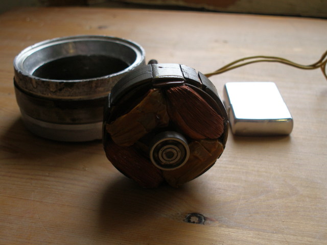

Hi i've been reading these wind generator forums for a while and become interested starting my own project.I'm gonna start with something just to play with.
I have an old fan motor 220V/30W...you can see it in the picture in the end of this message. There's a zippo to give some idea about the size of that thinghy.
What kind of amperage / volts could i expect from this motor when it's working as a generator?
According to messages i've been reading i would have to glue some magnets to the cylinder there to make it work as a generator...but how many and how strong ones?
Other question is about the re-coiling. What difference would it make if i would recoil that motor? The resistance of the coil is 185 ohms now.
How long propellers would be suitable for this kind of generator?

I Think you best pass on this one. You will get volts, But very little amps. You might light a led. But if you want to try. You will need 4 mags placed 90 deg apart. And about a (16")450mm Prop.. This type of Fan motors don't make good generators. The centre shaft will be stationary. The outside Housing will have to turn.
As for size of the mags as big and strong that will fit in the housing.
