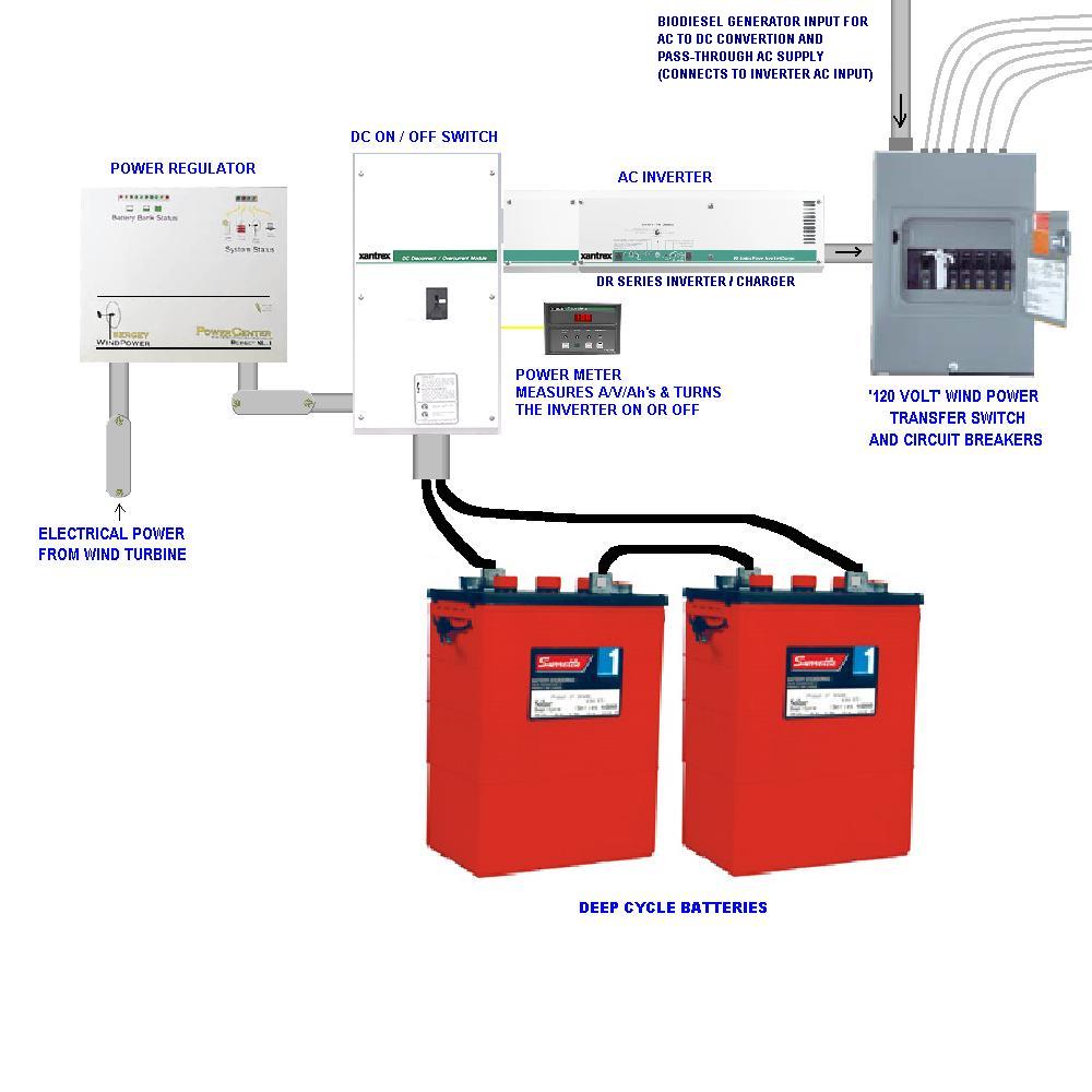

I can help you. I need to know some details about your location, such as prevailing wind direction, Your indented location for the tower, The local hieght restriction if any, is the surronding area close to any large trees?
Are you planning to errect the windmill yourself? What level of investment are you prepared for? $1000/$5000/$10,000?
If you are going use a biodiesel gen-set for backup, then I strongly suggest using a Xantrex 'DR series' inverter for your main source of AC power. This inverter has an automatic multi-stage high current battery charger built in. And when the diesel turns on the inverter will automatically start charging your battery bank. The instant your diesel generator shuts off the Inverter will convert your battery power into 120 AC power. The main inverter AC output connects to your load center (fuse box) and from there, supplies electricity to all of your electrical circuits in your house. At no time will you be in the dark.
This type of system will be the best for reliability and is well proven. It is also economical and simple. I can pre-assemble/wire the inverter and all other controls up to a 4' x 6' piece of plywood and ship it to you. The best batteries for your purpose are the ones shown in the picture. They are Surrette L-16's that are 460 Ah and they are made in Spinghill, Nova-Scotia http://www.surrette.com/home.htm
My email is: solarenergy@rogers.com
Good luck with your Biodiesel gen-set purchase.
I will be happy to upload pictures of your future wind/biodiesel hybrid system on this page.
