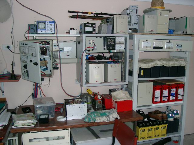

The black box in the middle rack is a 24-12v dc-dc truck converter-- good for 20 amps and I just tweaked the internal pot to allow 14.5v for charging a 12v bank ..
Have installed a pc fan in the back to cool the heatsink, This whole rack is for 12v from my 24v main solar system, the 24v from the bank runs those ups 240v cream boxes -been running for years now.
